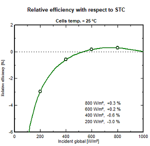

When entering the page "Model parameters > Rshunt-Rserie" in the PV module definition dialog, you are advised to choose "Relative effic." for seing the graph of the Low-light behaviour:
You can easily check by playing with the parameters that this low-light efficiency behavior depends on the 3 mentioned resistances:

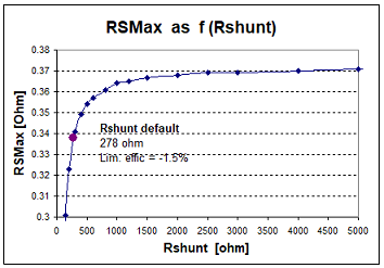

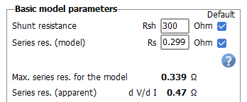

| - | The Rseries cannot exceed the Maximum value (RSerieMax) shown on this dialog (here 0.339 Ω). This may limit the desired Low-light performance. |
| - | The RSerieMax. is dependent on the RShunt value: it can be increased by increasing RShunt, but only up to some limited extent (saturation) as seen on this example graph: |
Therefore, when the desired Relative Efficiency cannot be reached, it is necessary to increase the Rshunt in order to increase the RSerieMax.

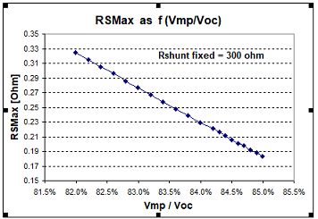

Vmp/Voc ratio limitation
The RSerieMax is also limited by the Vmp/Voc ratio at STC.
The next graph shows the evolution of RSMax, which is linearly but quickly decreasing with the Vmp/Voc ratio. You can notice that we have a decrease of -50% for an increase of only 3% of the Vmp/Voc ratio.
In practice, Vmp/Voc ratios greater than around 84% should be avoided.
Some manufacturers artificially decrease their Voc value, probably in order to increase the Fill Factor. We have sometimes observed values greater than 84% on the datasheet specifications, when the detailed measurements provided by an independent laboratory showed values below 82 or 83%.

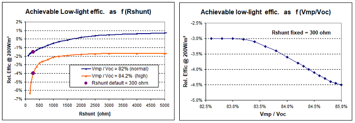

The next graph shows examples of the possible low-light efficiencies as a function of Rshunt and Vmp/Voc.
