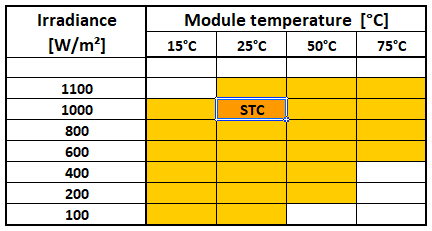

Fit on 5 parameters using IEC 61853 data
Many test laboratories use to provide  these 5 parameters specific to the PVsyst model  (Rserie, RShunt, RshExt, Rsh0, muGamma)  from their measurements.
The IEC standard requires the measurement of  the I/V curve (Isc, Imp, Vmp, Voc)  at 23 different Irradiance and temperature conditions:
Meas_IEC61853
They perform a 5-parameters fit over these 23 values.
We consider that such a fit cannot identify each of these parameter accurately:
▪First, because the uncertainties on these measured values are not negligible.
▪Secondly, the number of  experimental points is not sufficient for adjusting 5 parameters in such a non-linear set of equations.
▪Thirdly, the measurements are averages on 3 modules of same power, i.e. not "pure" measurements.
▪Fourth, the results of the fit are highly dependent on the STC chosen values. The parameters are required not for this specific module (with these measured STC values), but for modules of different power classes, therefore different STC values as specified on the datasheets. The whole set of points has to be adjusted for each of these STC conditions, which are obviously not compatible with the STC measured values.
When analyzing the results of a same measurement but for several power classes, the parameters are usually completely different for each power class.
In fact it is illusory to wait a reliable fit from such data: the 5-parameters function is probably a highly varying function with minima and maxima between the reference points. And it is not extensible nor stable when slightly varying reference data.
NB: These fits usually lead to aberrant values. For example the RshExp is often of the order of 10 to 15. This means a very sharp exponential, with constant value up to very low irradiances, i.e. no exponential behaviour as function of irradiance anymore. This is in complete contradiction with all our measurements.
And on some measurements, the muPmpp result of the fit was significantly different than the muPmpp direct measurement by conventional method (i.e. numerous Pmpp measurements by continuously decreasing the module temperature).  During the simulation this parameter is essential for a good evaluation of the temperature losses.

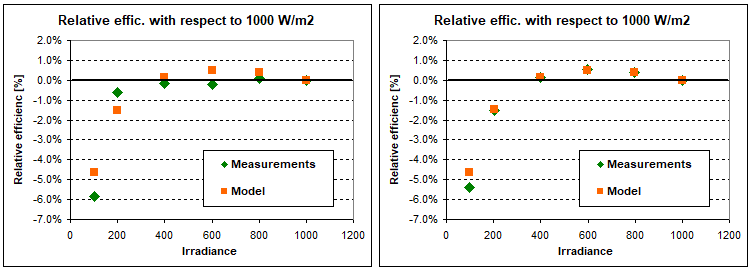

PVsyst methodology for filling the Database
We try to find a robust result, able to be extended to any "equivalent" module of different models or Power class.
We consider the basic parameters  (RshExt, Rsh0, muGamma)  as constant according to their standard values (and our general measurements). We only analyze the low-light behaviour at 25°C.  For any module (of any power class), we choose the Rserie (and eventually increase Rshunt)  in order to reproduce this low-light performance.
NB: This analysis is not always straightforward: we observe that the Isc is often not really linear with the irradiance. A deviation of 1% on the irradiance (obtained by filters) means a deviation of 1% on the relative efficiency.
Therefore we begin by analyzing the linearity of the Isc with the irradiance. This is supposed to be perfectly linear, so that we can correct the irradiance accordingly.
When doing this the rather erratic points on the measured relative efficiency curve become well aligned, and usually well matching the model.
Meas_LowLight
                      Rough published measurements                                 Corrected Irradiance, as linear with the measured Isc
