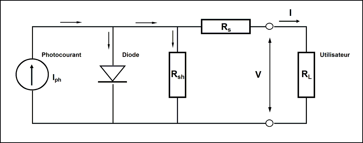

To describe the operating of a PV module, we use the Shockley's simple "one diode" model, described, for example, in Beckman and al. This model is based on the following equivalent circuit for decribing a PV cvell:
The model was primarily developed for a single cell. Its generalization to the whole module implies that all cells are considered as rigorously identical.

I = Iphref - IoRef [ exp (q · (V + I · Rs) / ( Ncs·Gamma·k·Tc) ) - 1 ] - (V + I · Rs) / Rsh
with :
| I | = Current supplied by the module [A]. |
| V | = Voltage at the terminals of the module [V]. |
| IphRef | = Photocurrent [A] |
| IoRef | = diode inverse saturation current [A] |
| Rs | = Series resistance [ohm]. |
| Rsh | = Shunt resistance [ohm]. |
| Gamma | = Diode quality factor, theoretically between 1 and 2, often less |
| q | = Charge of the electron = 1.602·E-19 Coulomb |
| k | = Bolzmann's constant = 1.381 E-23 J/K. |
| Ncs | = Number of cells in series. |
| Tc | = Effective temperature of the cells [Kelvin] |
In this equation, we have 2 unknowns (in blue), five parameters to be determined (in green) and some physical constants.
The determination of the 5 parameters is described in the next topic. It involves the STC data usually specified by the manufacturer.
After obtaining the 5 parameter's values, we can solve the equation for getting the I/V curve, i.e any point I = f(V) or V = f(I). As the equation is implicit, this requires to use a successive approximations approach.
