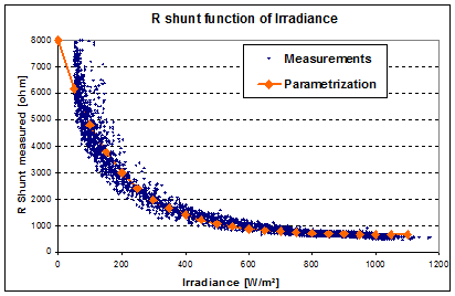

Rshunt expon
According to our long-term measurements of modules at sun, it appears that for all modules of all technologies the Rshunt measured value is strongly dependent on the Irradiance, and may be approximated by an exponential expression.
(here an amorphous module, EPV40).
We observed that in most of our measurements (crystalline, amorphous), an exponential parameter of 5.5 is suitable. For CdTe the suited value was about 3.0.
