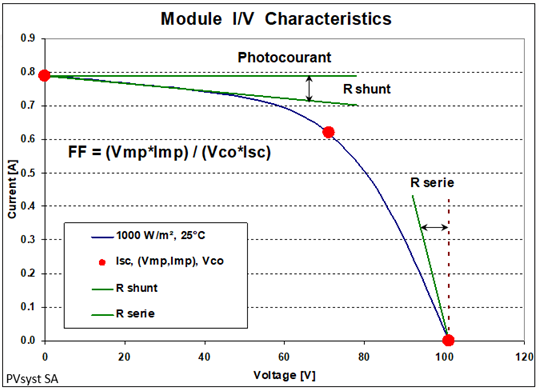

We can try to explain intuitively the different components of this equation:
- The IphRef value (photocurrent) is constant, whatever the voltage.
- The Rshunt current loss (component (V + I · Rs) / Rsh)) obeys ohm's law: this is a linear increase of current as function of voltage.
- The Rserie is a voltage drop between the internal cell voltage (V+I·Rs) and the Voc. This voltage drop also obeys the ohm's law.
- The difference between Rshunt and the blue exponential is the exponential current in the diode (simplified: IoRef · exp (e·V/K·T) term).
NB: We may observe that the Rserie defined within this model is not the inverse of the slope of the I/V curve around Voc. There is a contribution of the exponential.
The Rshunt is simply the inverse of the I/V curve around the point (V = 0, ISC). Therefore it is considered as known, and fixed in the equations.
Therefore we have still 4 variables to be determined.

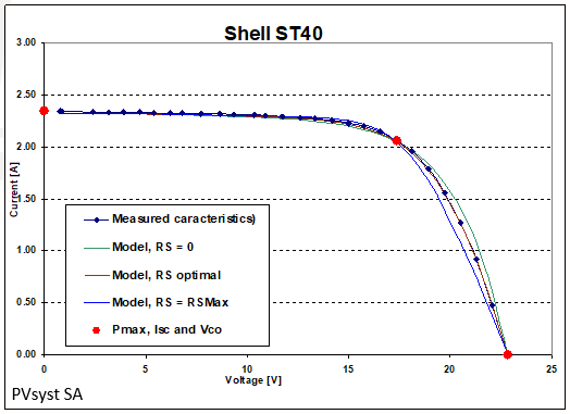

From the reference I/V curve measurement, we can extract the quantities IscRef, ImpRef, VmpRef, VocRef.
We may write the basic one-diode equations at the 3 known reference points: (0, ISC), (Vmp, Imp), (Voc, 0). The (Vmp, Imp) exact voltage position is not important. It may be "around" the maximum point. This gives 3 independent equations.
As we have 4 variables, for solving this system we have to fix one of the variable at an arbitrary value, so that there are 3 remaining parameters.
We begin by choosing to fix Rserie = 0. We solve the system and get a set of parameters, which allows to get the I/V curve for this situation.
Then, we may increase the fixed Rserie, and again solve the system. We do that until the system doesn't have a solution. This limit resistance will determine a value which we name RSMax, the maximum series resistance.
The real Rserie should lie between these 2 values. We can adjust it by finding the I/V curve which fits at best the measured points of the I/V curve.
RMS difference between Measured values and model The minimum is often as low as 0.4% of Isc for good measurements. |
We may observe that all curves are always passing by the 3 reference points: this is normal, as the solutions are based on the equations written at these 3 points.
