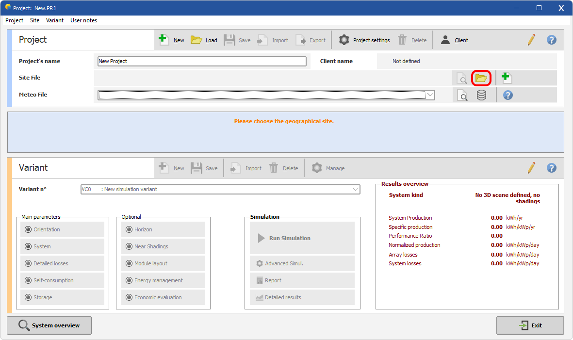

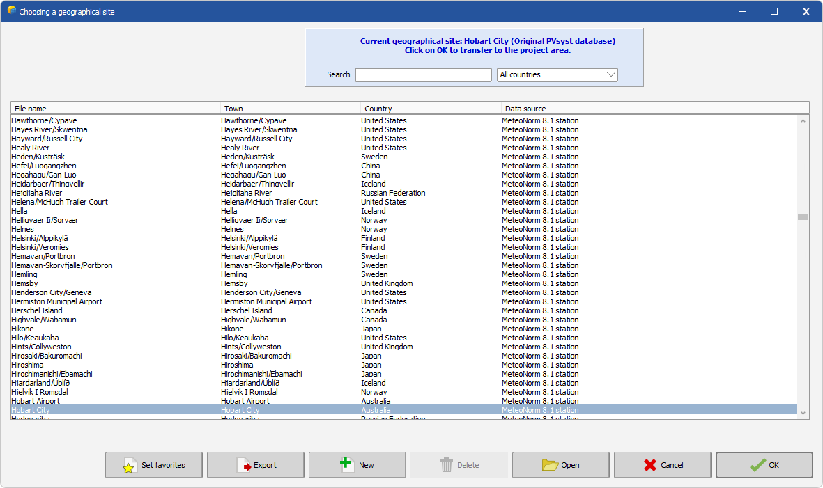

PVSyst show-up a message that invites you to load the geographical site. You can do it through the 'load site' icon marked by an asterisk.
This opens the geographical site interface, with a preselection on the lastly edited site (here Hobart). From this dialog, it is also possible to define a new geographical site, with a fallback monthly meteo set (either Meteonorm or NASA).

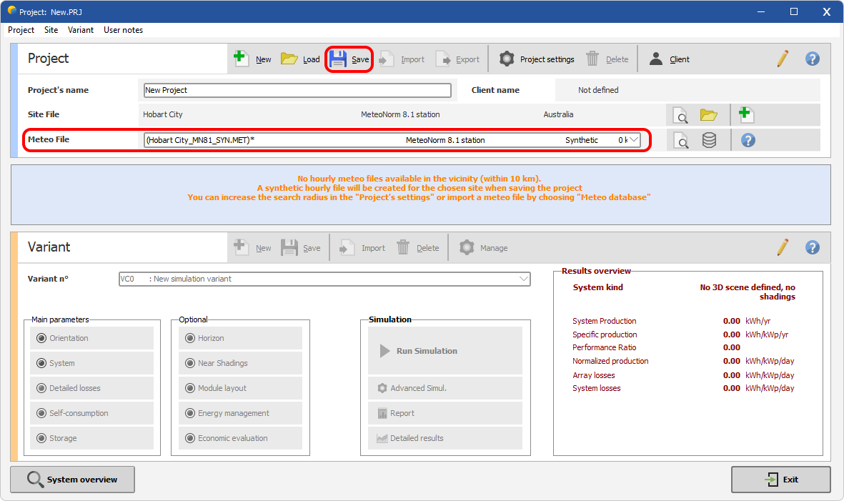

Once transferred into the project area, PVSyst will search all the meteo files available in the defined area and automatically select the lastly edited meteo file. Any import of new meteo files from this part of the software will enrich the list (in purple). When no meteo files are available, a fast way to start a project is to directly click on the save button (marked with an asterisk): PVSyst would then generate a synthetic file from the Meteonorm Dll and build a project ready to use.
Example of ready-to-use project with meteo file automatically built during saving operation.

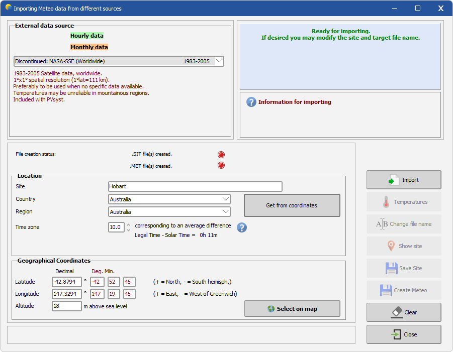

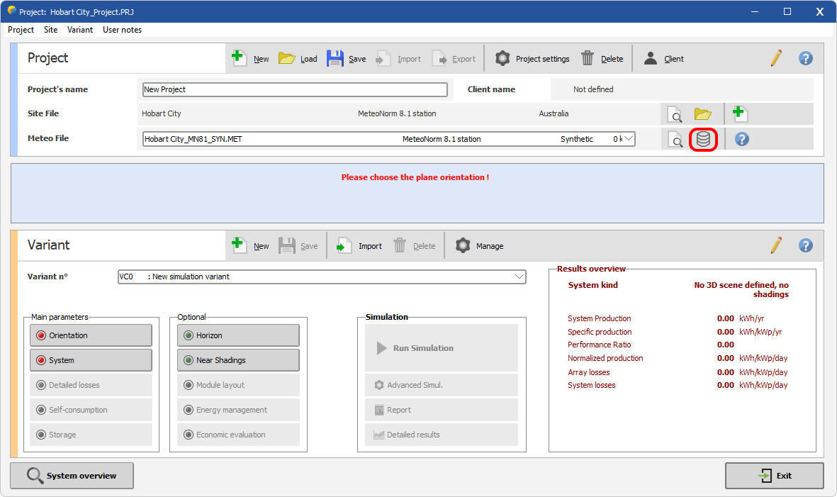

If you have downloaded meteo files on your hard disk from a service provider, you can transform them directly into .MET files from the project interface through the 'Meteo database' button.
For this example, we choose to import a meteo file for Hobart from the NASA-SSE Database, but it would work for any service.

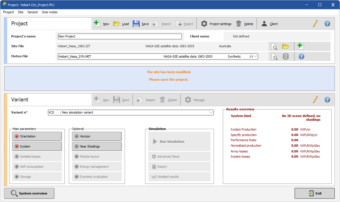

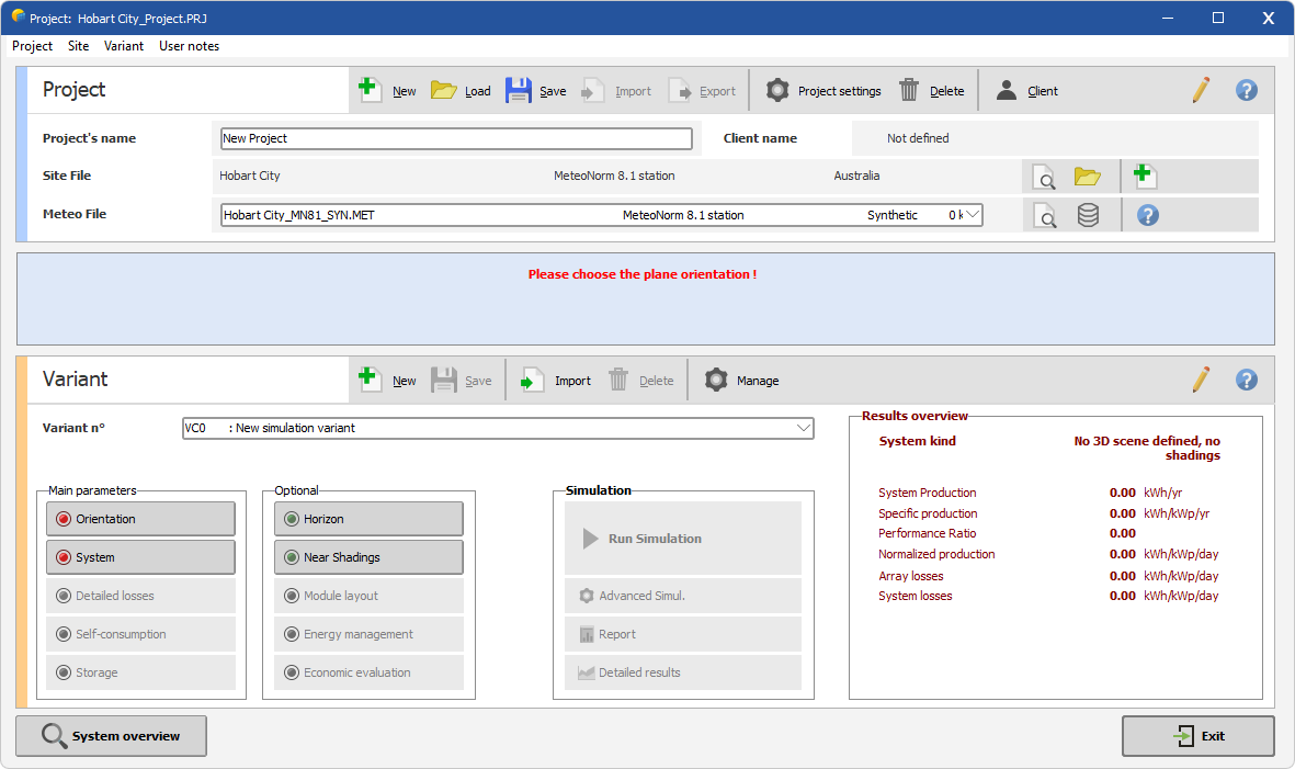

Back to the project area, PVSyst will select the newly created meteo file and build a project site from it. The project is then ready to be saved.
Finally, whatever method is chosen, the dialog will be similar as the one below, ready for variant definition.
