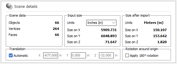

After a successful import a dialog summarizing what was found in the imported file will appear.
Scene details
This panel sums up the number of imported objects, and their total numbers of vertices and faces.
It also allows you to set the input unit in order to scale objects correctly in the PVsyst scene (currently always in meters).
When importing DAE files PVsyst will try to extract the unit from the file and set it automatically.
The import will be automatically translated to the origin (0,0,0) of the scene.You can however modify the translation parameters by unchecking 'Automatic' and by editing X, Y and Z.
There is an option to rotate all the imported objects by 180° around the origin (0,0,0) of the scene. This option is checked by default in the southern hemisphere and it is unchecked by default in the northern hemisphere. But you can check or uncheck it as you need.

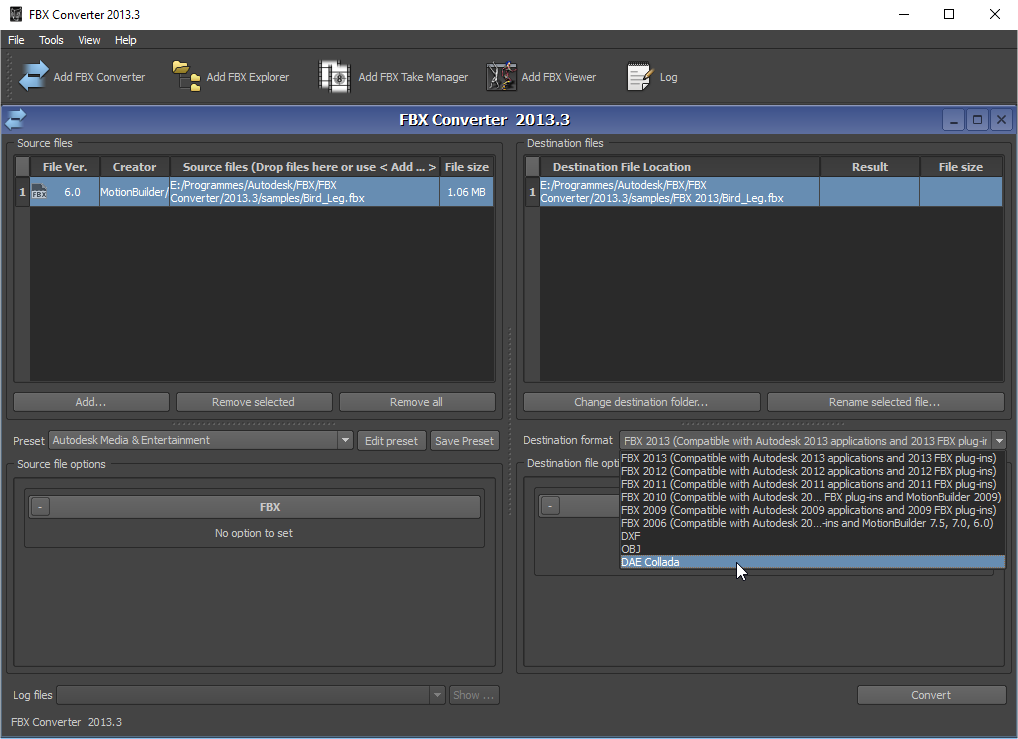

Importing from AutoCAD requires an additional step because it can't export directly to DAE.
You can either export your scene to Sketchup first and then to DAE (recommended option), or you can use a tool provided by Autodesk and called FBX Converter (which can lead to some issues, see below).
FBX Converter allows you to convert an FBX file generated from AutoCAD (and some other Autodesk products) to some other formats including DAE.
This way it is possible to import your scene in PVsyst. WARNING: Using FBX Converter can result in some objects being slightly misplaced in the resulting DAE file. If you use this method, we recommend to carefully check the placement of objects and PV panels in the shadings scene of PVsyst after import.
