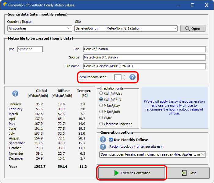

To get the synthetic hourly data from your monthly definitions:
•Select the Source data in the list, (you can verify if it is the site you want with "Open").
•Choose the First Random Seed (between 1 and 10).
•Press the  "Execute Generation" button.
The "Use monthly diffuse" option is for information only and remains checked (follow the link).
Dialog_Synthetic_hourly_data_generation_sample
