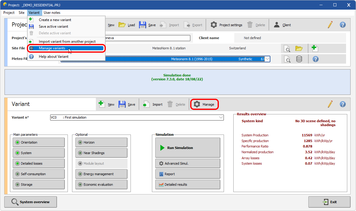

Project is composed of several variants. They can be managed from the variants management dialog box that can be opened by clicking on the menu Variants -> Manage variants or on the button Manage:
