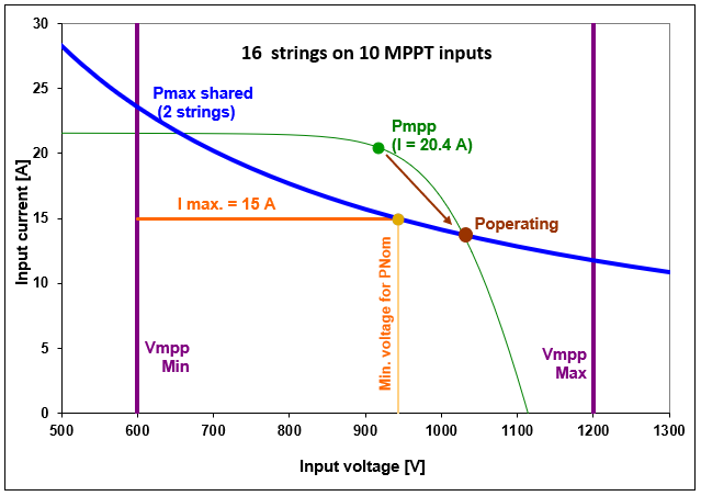

We suppose an inverter of PNom = 120 kWac, with 10 MPPT inputs, and a current limitation of 15 A per input.
We connect strings of 30 modules of 340 Wp, with an Imp = 10.2 A. This corresponds to a power of 9.4 kW per string under 1000 W/m2 and 45°C.
If we connect 16 strings, i.e. 4 inputs with 1 string, and 6 inputs with 2 strings: the available PNom for doubled strings inputs will be PAvail = PNom(Inv) - 4 * POper(1 string) = 120 kW - 4 * 9.4 kW = 82.4 kW on 6 inputs, i.e. 13.7 kW per MPPT input.
We have obviously a possible excess of current. However the overload conditions will move on the (PMax shared) curve, and the overload will be accounted as Power overload.

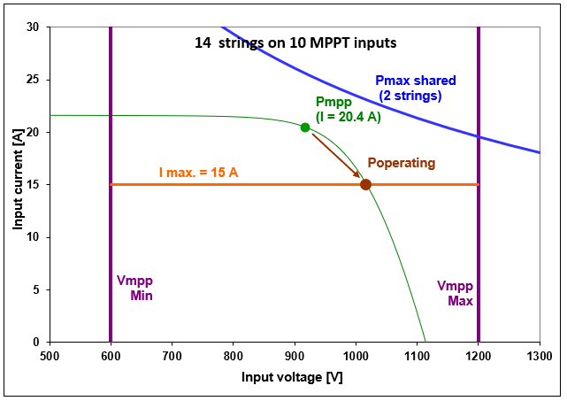

Now if we only connect 14 strings to this inverter, i.e. 6 inputs with 1 string and 4 inputs with 2 strings, the available power for the 4 double strings is higher:
PAvail = PNom(Inv) - 6 * Poper(1 string) = 120 kW - 6 * 9.4 kW = 63.6 kW for 4 inputs, i.e. 15.9 kW per MPPT input.
Therefore the power limit is not attained and the current limit will be activated for these 6 double inputs:
Therefore we see that the overload behavior conditions are rather complex. The PVsyst simulation treats correctly this situation.
