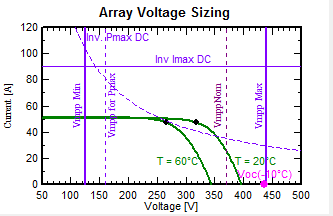

The number of modules in series has to match the following conditions:
| - | The minimum array operating voltage (i.e. at max. module operating temperature, 60°C by default) should be above the minimum inverter's operating voltage (Vmin of MPPT range). |
| - | The maximum array operating voltage (i.e. at min. module operating temperature, 20°C by default) has to stay below the maximum inverter's operating voltage (Vmax of MPPT range). |
| - | The maximum array absolute voltage (i.e. Voc at min. temperature, -10°C by default) has to stay below the absolute maximum inverter's input voltage. |
| - | The maximum array absolute voltage (i.e. Voc at min. temperature, -10°C by default) should not overcome the maximum system voltage specified for the PV module. |

Please see the diagram in the "System" definitions, button "Show sizing", which summarizes all these constraints:
