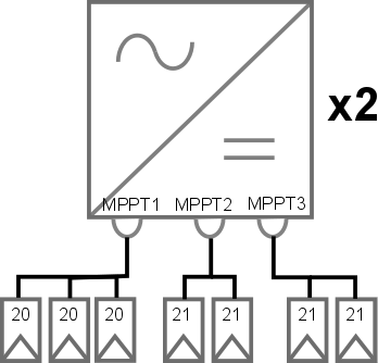

Example 4
We take a PV installation using 288 Modules and 2 inverters with 3 inputs each. The strings should be 20 or 21 modules long. On one MPPT input, strings should have the same number of modules.
We therefore end up with 8 strings of 21 modules and 6 strings of 20 modules. These have to be distributed among the 2x3 MPPT inputs. This means that there are two inputs with 3 strings each and 4 inputs with 2 strings each. To get a balanced configuration, one of the inputs in each inverter will have 3 strings, and the other two 2 strings. The inputs with 3 strings cover the strings of 20 modules.
This means, that one of the inputs in each inverter will have 60 PV modules, and the other two will have only 42 modules each. To get a balanced situation, the Power sharing needs to be adjusted for equal nominal power. This means:
•42% of the nominal power for the inputs with 3 strings, and
•29% of the nominal power for each of the inputs with 2 strings.

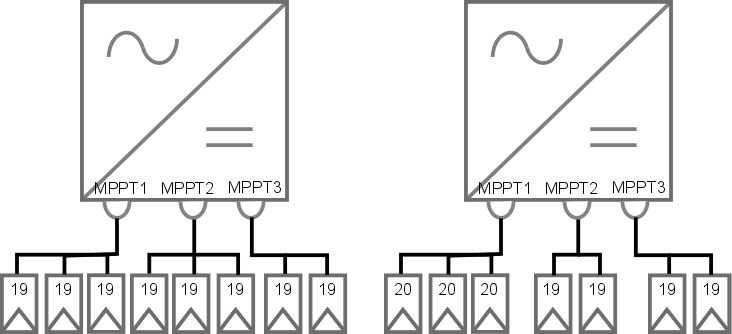

Example 5
As an example, let us take the same number of modules as before (288), but limit the string length to a maximum of 20 PV modules. In this case, 15 strings would be needed:
12 strings with 19 modules each, and 3 strings with 20 modules each.
The 15 strings have to be shared by two inverters, meaning that one inverter takes 8 strings and the other one 7. To balance the system, we put the 3 longer strings on the inverter with 7 strings. This leads to the following configuration:
Inverter 1:
2 inputs with 3 strings of 19 modules (sub-array #1)
1 input with 2 strings of 19 modules (sub-array #2)
(152 / 288 modules = 53% of DC power)
Inverter 2:
1 input with 3 strings of 20 modules (sub-array #3)
2 inputs wit 2 strings of 19 modules (sub-array #4)
(136 / 288 modules = 47% of DC power)

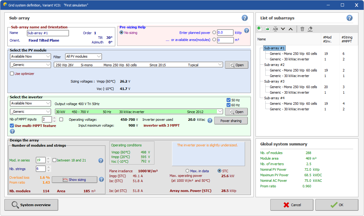

To configure this level of detail, we need to create 4 corresponding sub-arrays. For example for sub-array #1:
multimppt_example5_system

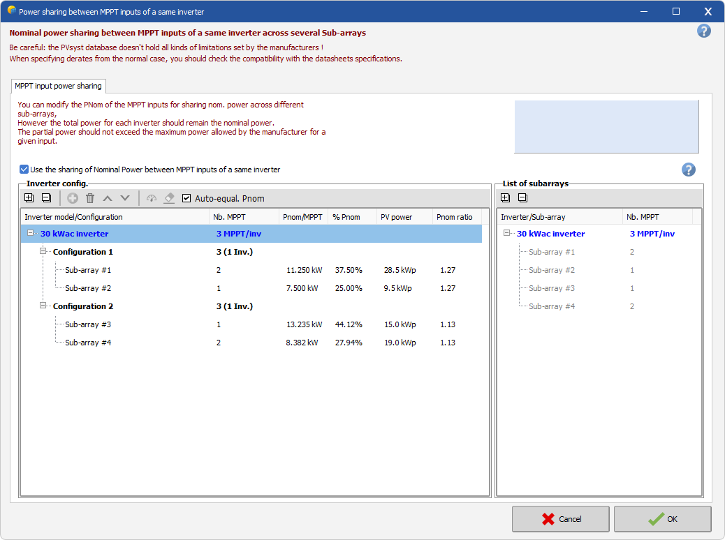

In the power sharing, we associate sub-arrays for the same inverter.
Group 1: sub-array #1 and #2
Group 2: sub-arrays #3 and #4
Finally, we balance the nominal power between the inputs ('All Pnom Ratios identical'):
Sub-array #1 (Group 1): 37% of nominal AC power
Sub-array #2 (Group 1): 26% of nominal AC power
Sub-array #3 (Group 2): 44% of nominal AC power
Sub-array #4 (Group 2): 28% of nominal AC power
