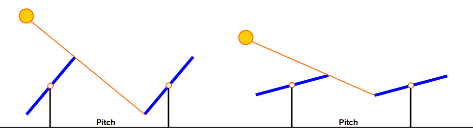

Let's analyze the case of a simple Horizontal N/S axis system.
Beginning of backtracking Backtracking situation: lower sun
Collectors perpendicular to sun profile angle Tracker tilt decreased
When the backtracking is activated, the collector plane is not perpendicular to the the sun profile angle anymore; we have a loss of irradiance, due to the cosine (or transposition) effect.
