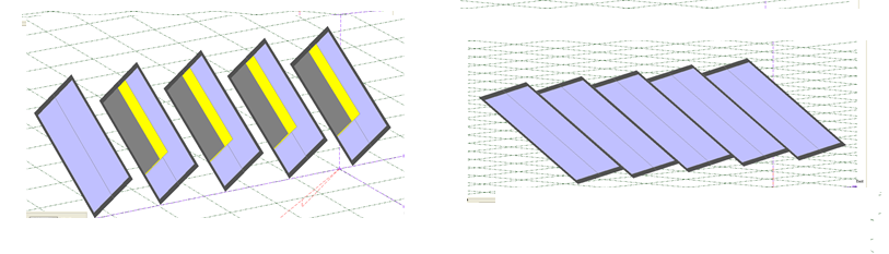

Comparison of backtracking with "normal" tracking
When the trackers perform a "normal" tracking (most perpendicular to sun as possible, with mutual shadings), or perform a Backtracking (deviating from the optimal orientation) they intercept about the same "Light tube" !
| - | With normal tracking, you have the mutual shading losses including the electrical mismatch shading losses. |
| - | With backtracking, you have losses for mis-orientation (cosine effect), with additional losses due to shadings on diffuse and albedo, as well as higher IAM. |
No backtracking: mutual shadings + electrical losses (yellow) Backtracking: no mutual shadings, but orientation not optimal

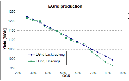

Yield comparison
As an example, we have done a comparison of the yield between "normal tracking" (with shades) and backtracking, for a N/S axis horizontal tracking system at Santiago (Chile).
The phi angles limits are +/- 60°, there are four rows of modules in landscape in the width of the trackers. The performance is very similar, except at very high GCR's:

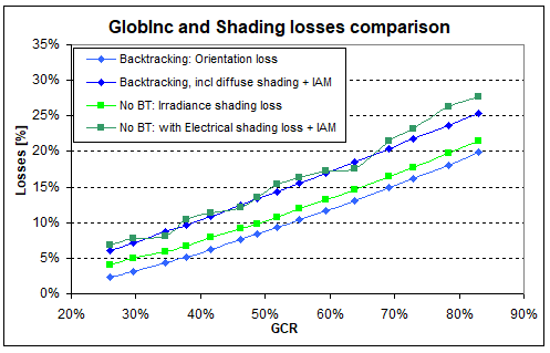

Losses comparison
Now if we have a look on the different losses, we may observe that:
| - | With backtracking, the losses due to the mis-orientation are slightly lower than the "linear" shading losses without backtracking (irradiance deficit, including for diffuse). |
| - | The electrical losses + IAM without Backtracking are very similar to the losses due to albedo and diffuse shadings + IAM with backtracking. |
| - | We can notice that with backtracking, the loss on diffuse diminish and the IAM increase with high GCR, due to the fact that the backtracking limits significantly the tracking angles. Both effects compensate each other. |
