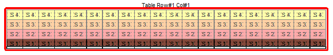

This corresponds to a shading situation of this kind: only the bottom sub-modules are shaded:

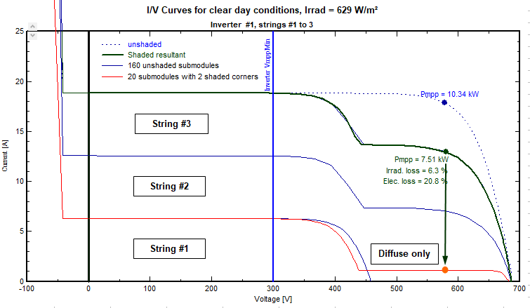

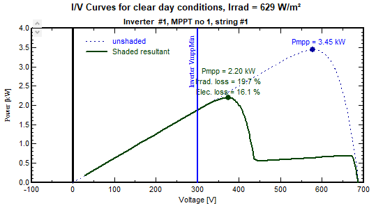

We will try to understand this by observing the corresponding I/V curves, as calculated by the Module Layout model.
When we have one only string on the inverter input, the Maximum Power corresponds to the Pmpp of the unshaded sub-modules I/V curves. This means that if we have 1/3 of shaded sub-modules, the shaded Pmpp will be 1/3 of the normal Pmpp.
However this is not quite true because for each shaded submodule, the by-pass diode is activated, and leads to a voltage drop, therefore a Power loss. On the graph below, the blue characteristics corresponds to the 40 unshaded submodules, and the resultant shows the voltage drop.
On the graph above, this loss in diodes explains the gap between the MPPT loss factor (blue line) and the Linear, fully shaded straight line.
NB1: If the shaded Vmpp is lower than the minimum voltage of the inverter (VmppMin), then the operating point will be on the intersection of this voltage and the I/V curve: the electrical loss will very quickly rise to the maximum loss, up to the diffuse contribution, loosing the advantage of the 1-string per MPPT configuration. For this advantage, we should have an inverter accepting a very large voltage range.

On the top graph, we observe that for 3 strings the shading loss is already maximum when we have 1/3 of shaded sub-modules.

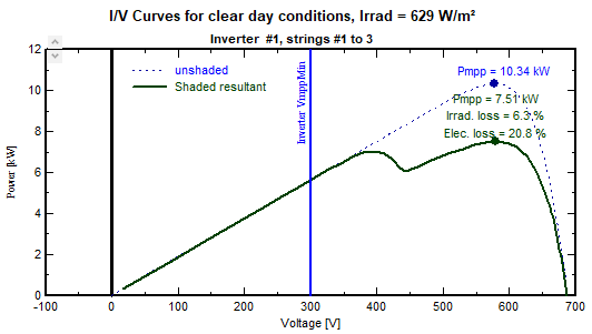

This corresponds to the following I/V curves: the first string partially shaded is identical to the previous one. But the 2 unshaded strings modify the resultant curve, and especially the Maximum power point: now the MPP imposes the voltage to all strings connected in parallel, and the operating point on the shaded string corresponds to the residual diffuse contribution.
This is the explanation of the affirmation above: the string contribution for the beam component is completely inactive !
NB: With this situation we are no more sensitive to the limitation with the VmppMin of the inverter.
On the top graph, the increasing parts of the curves correspond to the situation when the first MPP is higher than the secondary MPP due to the diffuse contribution. The plateau begins when the maximum is on the diffuse part (see the graph just above).
In this situation, we observe that with the 2-strings configuration we have still some contribution of the beam.
This graph was established for a 15% diffuse contribution. When the beam contribution decreases, the situation is improving and the curves move to the right.
