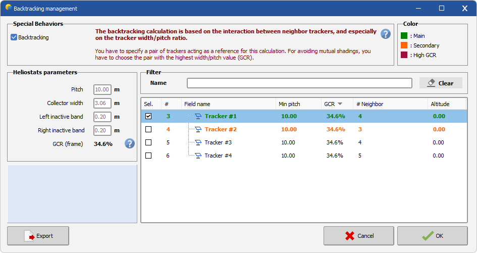

Therefore we have to identify a pair of two reference trackers as reference for the full backtracking calculation.
This is the objective of the tool "Backtracking management", available in the menu "Tools" of the 3D editor.
This identifies and lists the pitch between all neighbor trackers, and sorts them as decreasing pitch.
You have simply to select one tracker (among the higher GCR) and the tool will propose (select) the neighbour tracker to be associated (in orange).
There is a relationship between this tool and the 3D scene: the chosen reference tracker appears in green, and its neighbor in orange. This allows to visually check that the chosen tracker is really representative of the full set of trackers.
The detailed parameters involved in the backtracking calculation are shown in the frame "Heliostats parameters" on the left.
By deselecting the reference pair of trackers, one may also enter custom values.

If you have an irregular system, with some different pitches, and you are not satisfied with the "maximum pitch" choice, you can choose another pair of tables. The tool will show all the tables with a higher pitch in red. For these tables the backtracking will not be perfectly operational: there will be some possible mutual shadings. If you accept this situation, you have to activate the Electrical shading effects in your simulations.
