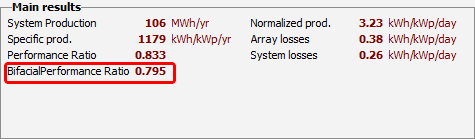

In PVsyst, in order to calculate the bifacial PR, the rear side irradiance is approximated as GlobBak + BackShd, where GlobBak is the effective irradiance on the rear side of the PV modules, and BackShd are the losses induced by the 'Structure shading factor' in the bifacial model definitions.
The bifacial PR then becomes
PRbifi = PR / (1 + (GlobBak + BackShd)/(GlobInc))
Please note, that this concept of bifacial PR is by nature blind to changes in ground albedo, mounting height and to the effect that row spacing and PV module orientation have on the bifacial contribution.
In the simulations of bifacial systems, the bifacial PR calculation will be displayed separately in the main results summary. By definition, it will be smaller than the standard PR value.

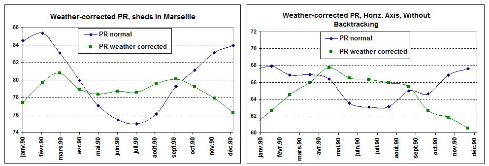

Weather-corrected PR
For short time analysis (commissioning, one-week tests), a NREL paper proposes a "Weather-corrected Performance ratio". It has since then been included in the norm IEC 61724-1.
The objective is to get rid of the seasonal variations of the PR, mainly due to the varying array temperature. Other weather contributions like irradiance level, wind velocity, varying soiling, etc are not taken into account in this approach.
The proposition is to define an average array temperature, which is an average over all operating hours in the year, weighted by the incident irradiance GlobInc.
Then for a specified period, the PR (corr) is defined by the following equation:
PR (corr) = E_Grid / ( PNomPV * Σ hours ( GlobInc / GRef * (1 + muPmpp * (Tarray - TArrayAver) ) )
Where :
- GlobInc = incident irradiance in hourly values
- GRef = 1000 W/m²
- muPmpp = Pmpp temperature coefficient of the PV module
- TArray = Array (cell) temperature of this hour
- TArrayAver = Array temperature average over the whole year, weighted by GlobInc, i.e.:
TArrayAver = Σ hours (GlobInc * TArray) / Σ hours (GlobInc)
Mathematically, if the TArrayAver is calculated with the same data, the yearly PR(corr) value should be equal to the yearly PR.
We have implemented this in the PVsyst version 6.74. However the result is not so convincing, because in most PV systems, other contributions are season-dependent.
With shed-systems, applying this PR correction seems to over-correct the PR seasonal behavior. This is due to the mutual shadings, which are more pronounced in winter.
This correction is almost unusable with tracking systems, as the seasonal variations due to tracking are largely dominating the temperature effect.
