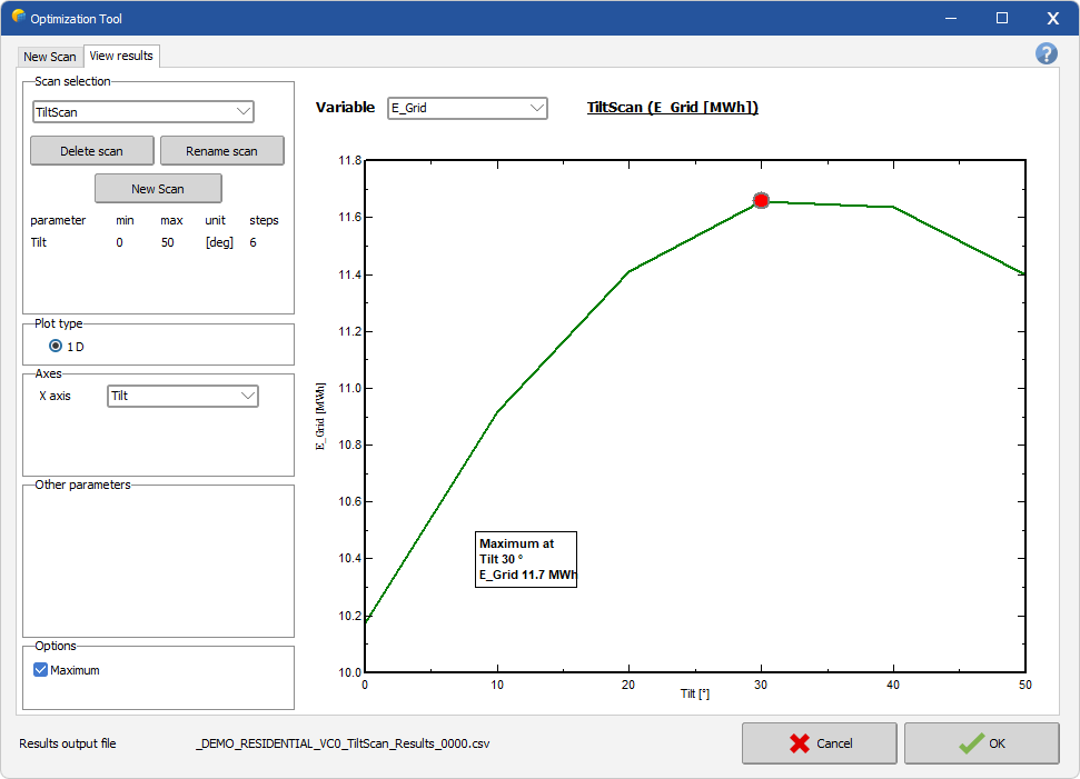

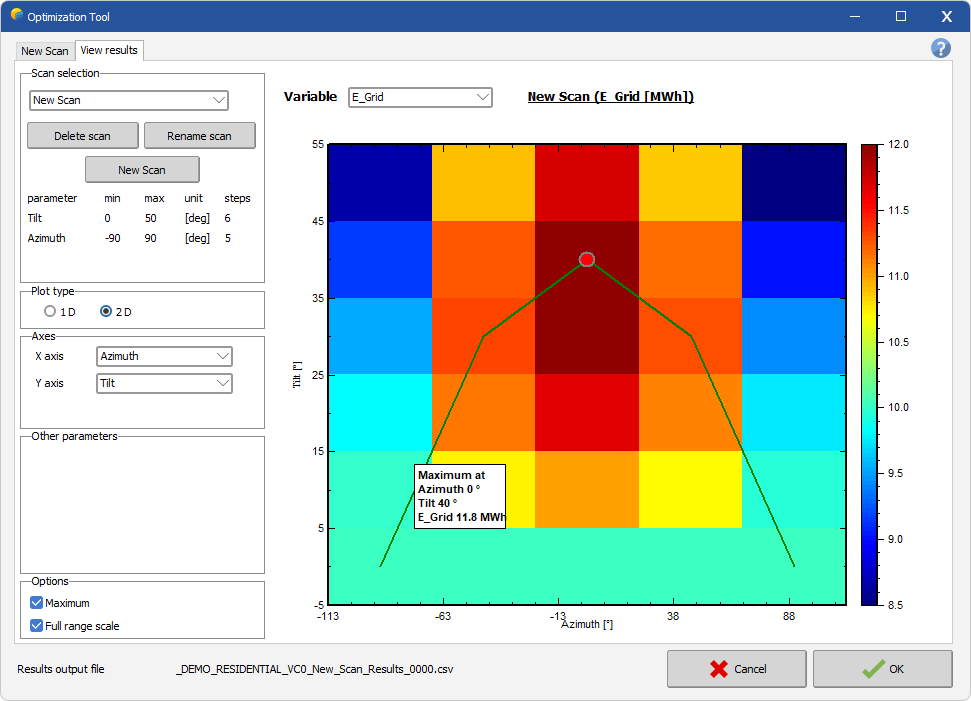

The results can be displayed either in a one- or a two-dimensional plot. The 1D-version is a curve of the result variable as function of one of the parameters. The 2D-version is only available, if two or more parameters were scanned. It consists of a colored surface with one parameter on each axis and the variable value being color-coded. The color code ranges from dark blue for small values to dark red for high values.
1-Dimensional Plot

2-Dimensional Plot

Axes
In this group the axes are associated to parameters that were varied in the scan. In a one-dimensional plot, only one parameter for the X-axis needs to be chosen, for two-dimensional plots, parameters have to be associated to both, the X- and the Y-axis.
Non-displayed parameters
If more than one parameter was varied within a scan, it can happen, that one or more parameters are not associated to any of the axes. These are the 'non-displayed parameters'. In this case, a field with a spin button and a slide bar will appear in this group for each non-displayed parameter. These controls allow to set a value for this parameters, and the plot will be updated accordingly.

•Maximum: If this option is checked, the maximum value in the plot will be marked with a red dot, and its values of the parameters and variable will be displayed in a text box
•Full Range Scale: If this option is checked, the range of the scale for the variable will be chosen so that it covers all values from the scan. Changing the non-displayed parameters will have no effect on the displayed variable range. If on the other hand this option is unchecked, the range of the Y-axis for 1D plots and the range of the color code for 2D-plots will adapt to best cover the values that are actually displayed. Changing the values of the non-displayed parameters will now change these ranges.
