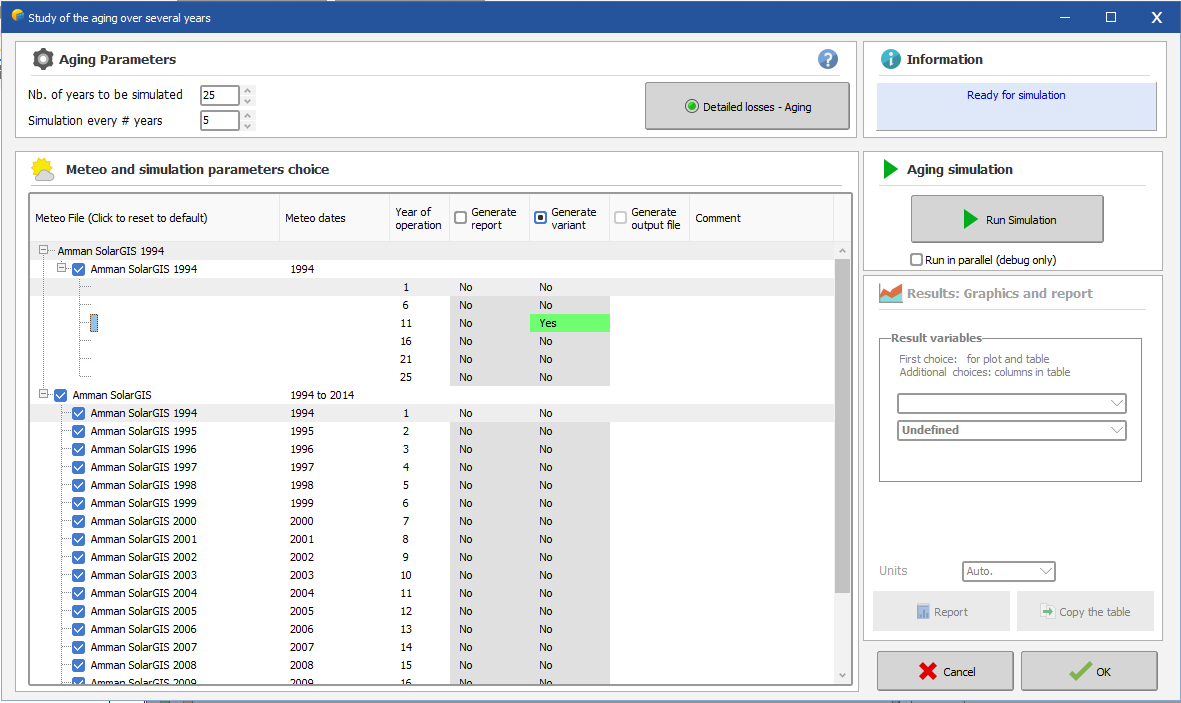

When entering this tool, the blue panel (top right) will indicate what to do.
| 1. - | You have to define the basic degradation parameters (module degradation rate, mismatch evolution). If you have already defined the degradation in the "detailed losses" of your main simulation, this will take these parameters as initial values. But you can define any other ones for this tool. |
| 2. - | A tree view will show all the available meteo data files available in the vicinity of your project. There may be single generic files, or series of yearly meteo data. Note that only the files containing a full year of data are available here. |
| 3. - | You should select the meteo or groups of yearly meteo that you want to simulate. It is possible to simulate up to 2 groups at a time. |
| 4. - | With single meteo files, you may specify the total number of years to be analyzed, as well as the time interval between the simulations really executed. The intermediate years will be interpolated. |
| 5. - | It is possible to create specific variants, generate reports or generate the hourly output files (if available in the original simulation) for chosen simulations. For this simply click on the corresponding cases in the table.. |
| 6. - | When everything is ready, click on "Run simulation". |

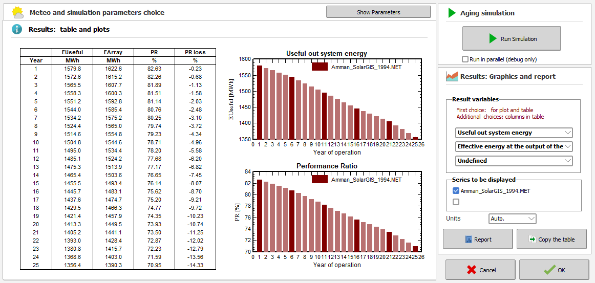

After the simulation you directly obtain the results, as a table and 2 graphs.
You can choose the variable to be shown on the first graph The second graph will always show the evolution of the PR.
Besides the PR and its loss percentage evolution, you can get up to 3 chosen variables on the table.
All these results will be shown on the report (2 pages).
Export: The button "Copy the table" allows to paste the table directly in EXCEL.
NB: it is always possible to retrieve the input parameters by clicking the button "Show parameters".
