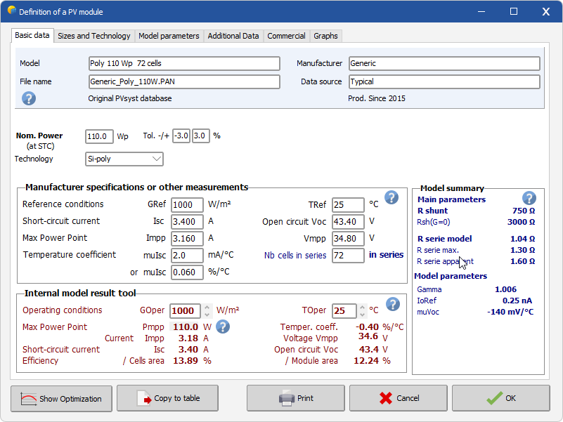

The PV module parameter and properties, as well as their behavior, are defined through a 6-sheet dialog:
| Basic Data, | Model type definition and main STC parameters, |
| + Tool showing the main results of the model, for any Irradiance and temperature conditions. |
| Additional data | Additional optional data specified for this module, and tools for the elaboration of the model. |
| Low-light efficiency - Measured I/V curve - Sandia model parameters - IAM specifications - secondary parameters. |
| Size and Technology | Module and cells sizes, by-pass diodes, secondary characteristics, other specifications |
| Graphs | a tool to visualize usual and less usual graphs of the PV-model behavior over a great variety of operating conditions. |
Synthesis of parameters associated with any module in PVSyst Database :
"Basic data":
| Tolerance: | +/- tolerances specified for the Nominal power. Only used in PVsyst for establishing the default value of the "Module quality loss" factor (fixed at Low tol + a quarter of the difference (High-Low)). |
| Technology | Gives choice for the main technologies of PV modules available on the market. Acts on the model. |
| GRef | Reference irradiance for the (Isc, Voc, Impp, Vmpp) specifications. Usually STC = 1000 W/m². |
| TRef | Reference temperature for the (Isc, Voc, Impp, Vmpp) specifications. Usually STC = 25°C, |
| Isc | Short circuit current at (GRef, TRef) conditions, |
| Voc | Open circuit voltage at (GRef, TRef) conditions, |
| Impp | Max. power point current at (GRef, TRef) conditions, |
| Vmpp | Max. power point voltage at (GRef, TRef) conditions, |
| muIsc | Temperature coefficient on Isc [mA/K] or [%/K] |
