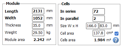

After ensuring that you have correct values for:
▪The module sizes
▪The number of cells in series and parallel,
▪The number of diodes,
▪The Submodule partition (layout)
you will get this dialog (this example is for a twin half-cut cells module):
CellSizeDeterm
It is always possible to manually modify the sizes (width and height)  of the cell. You will have a warning at the bottom of the dialog  if your choice is not compatible with all the module data.
The checkbox on the right of the cells area indicates that the values are compliant with the determination of PVsyst.
You can always retrieve the PVsyst determination (if valid) by clicking on this checkbox.
