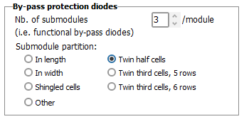

Definition in the PV module dialog
The architecture is a basic definition of the PV modules parameters (PAN files), useful especially when dealing with electrical shadings.
It is closely related to the number of cells in series. The usual voltage of modern crystalline cells is 0.56-0.57 V/cell. Therefore the number of cells in series may be estimated using the specified Vmpp at STC.
There are several other possible configurations. You can get them in an additional combobox, when checking "Others" in this dialog.

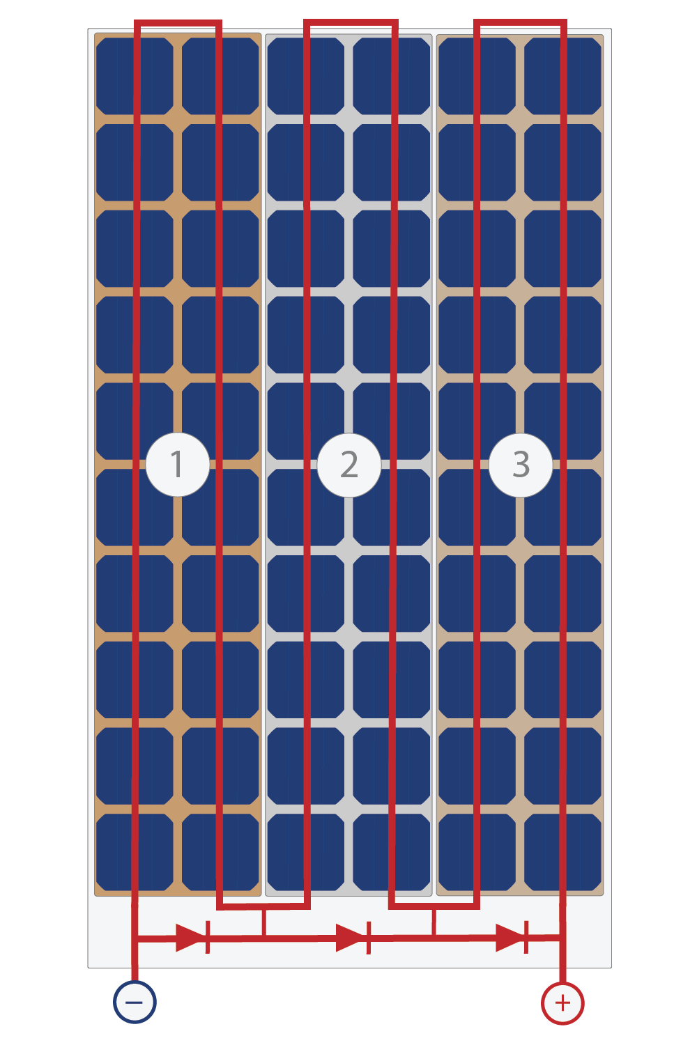

In Lenght This is the basic organization of all historical PV modules. The old modules of 36 cells had 2 submodules "In length", and therefore 2 by-pass diodes. The usual modules have now 60 or 72 cells (rarely 48, 54 or 96), with 3 by-pass diodes, i.e. 3 submodules "In Length". With cells of 156 to 166 mm, the gives module widths of the order of 0.99 to 1.05 m in width. The length depends on the number of cells. Modules of 60 cells are about 1.62 to 1.72 m, when modules of 72 cells have 1.93 to 2.04 m length. In these modules, the connexion of the by-pass diodes in a junction box requires a bus in the width of the module.

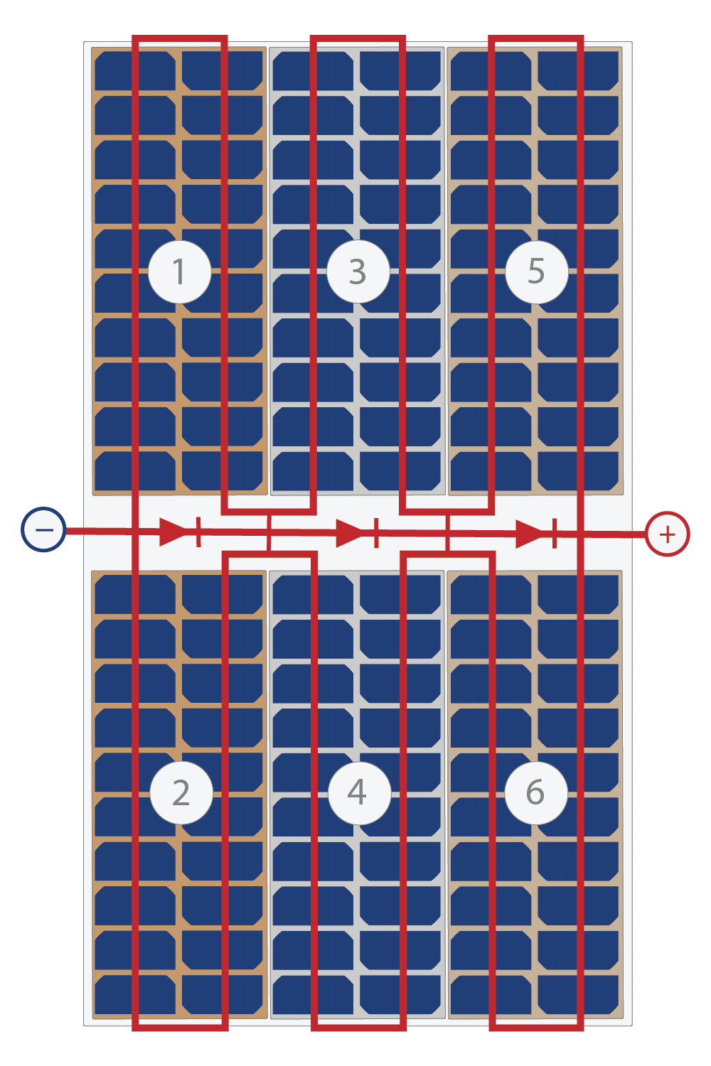

Twin half-cut cells . More and more modern modules are now organized in this configuration. This uses series of half-cutted cells. Each submodule is made of a series of 20 or 24 cells, and 2 submodules are connected in parallel, with one common by-pass diode. The advantage is that when some cells are shaded in the bottom part, the upper part of the module is still active, minimizing the electrical shading loss. Therefore in a row arrangement, these modules should be used in portrait. Each sub-module has 20 (or 24) cells in series. Therefore NCells in series = 60 (or 72), i.e half the total number of cells specified on the datasheets. And the number of cells in parallel is 2. The global sizes of these modules are comparable to the equivalent modules "in length". There are other technological advantages: this minimize the series resistance, and diminishes the risk of cracks. This technology seems to favor the efficiency: modules of a same manufacturing processes get slightly better efficiencies.

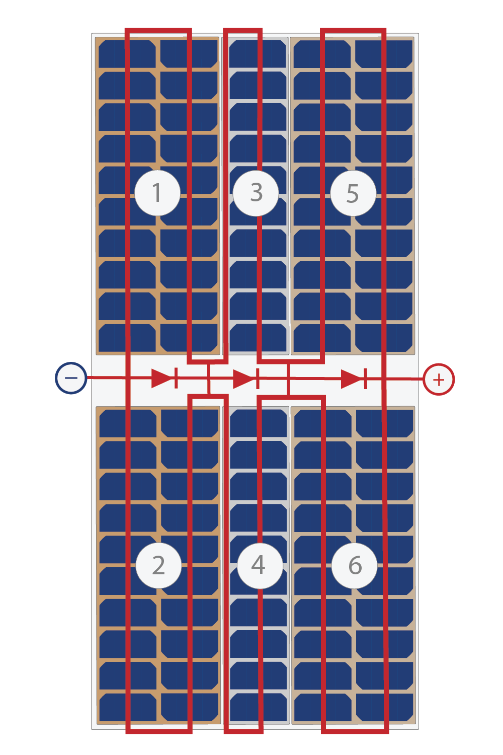

Twin third-cut cells, 5 rows . With the increase of the cell sizes (182 and now 210 mm), some manufacturers try to keep the PV modules close to usual sizes. They diminish the number of rows (5 * 210 mm lead for about 1.1 m width) and use 1/3 of cells for limiting the lenght - and also the current. The number of cells in series may be 22 + 11 + 22 (i.e. 55 cells) or 24 + 12 + 24 (60 cells), etc. It should be divisible by 5. This configuration requires that for the central submodule, a copper connexion strip leading the half-current of the module has to be deployed along the sub-module.

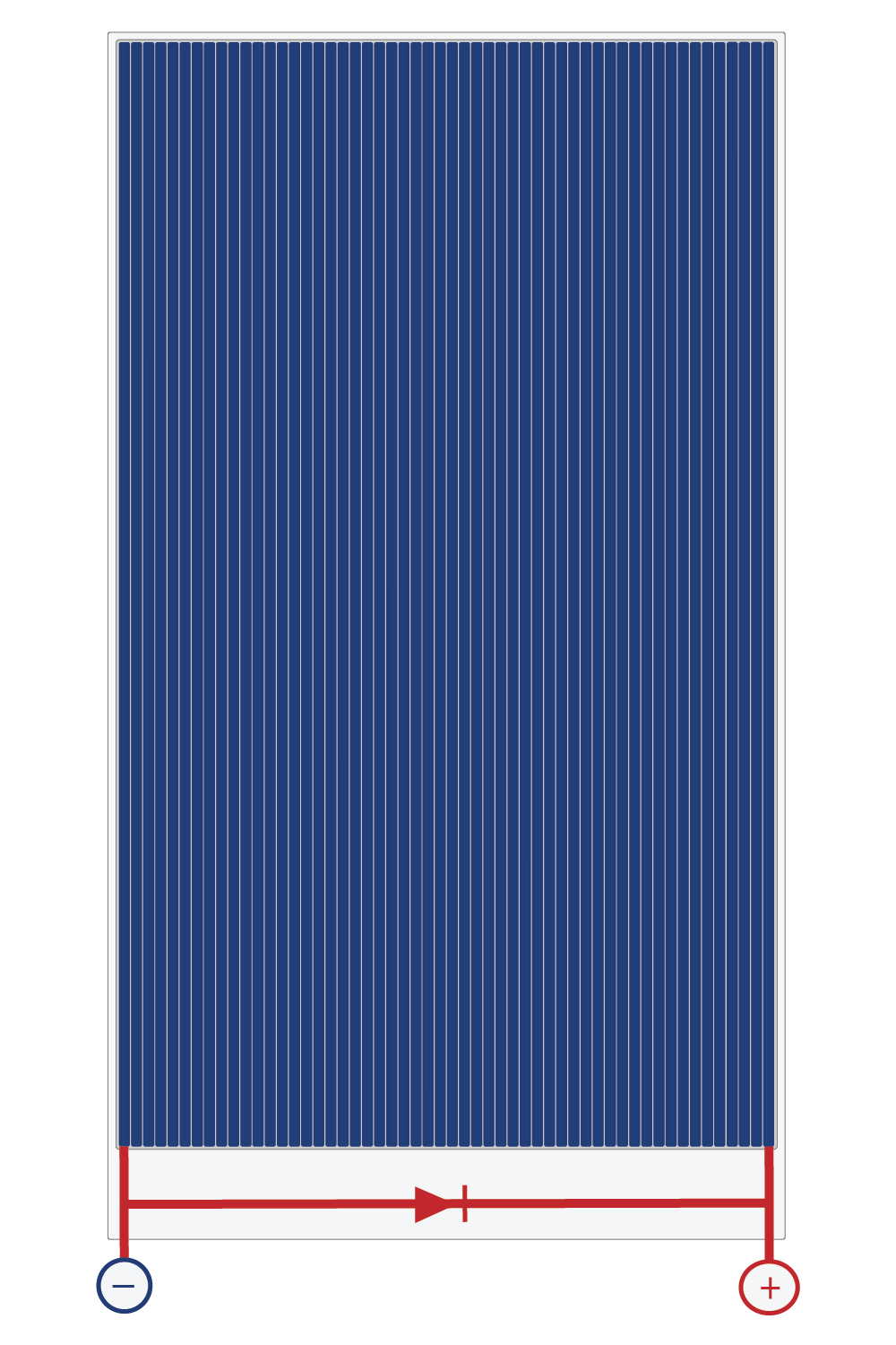

Strips in length Strips in width In the thin film modules (CIGS, CdTe, amorphous) the cells are strips of about 10 mm width, on the full length of the module. In some cases, the strips may also be in the width of the module. This means that the number of cells in series is closely related to the modules size (width or length). Some Thin film modules have a very high number of cells (for example first Solar CdTe: 270 cells in series for a Vmpp around 185V). Most of the thin film modules have one only by-pass protection diode for the whole module. This is because the connection from cell to cell is indeed distributed on the whole length of the cells, so that it is not possible to get a middle point connection. This is not a problem because a single cell is unlikely to be shaded. When installed in a row-like system, the strips should always be disposed perpendicularly to the possible shades. In this way all cells will be partially shaded in the same way. Therefore the thin film modules are not suffering of electrical shading losses.
