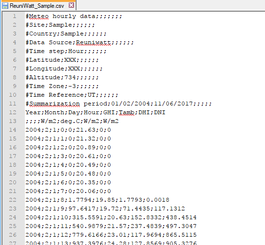

The hourly data is provided in the PVsyst standard format, for a direct and easy import in PVsyst.
Reference time of meteo files is GMT (universal time, UT).
Native ReuniWatt files contains more data. All of them are listed below :
