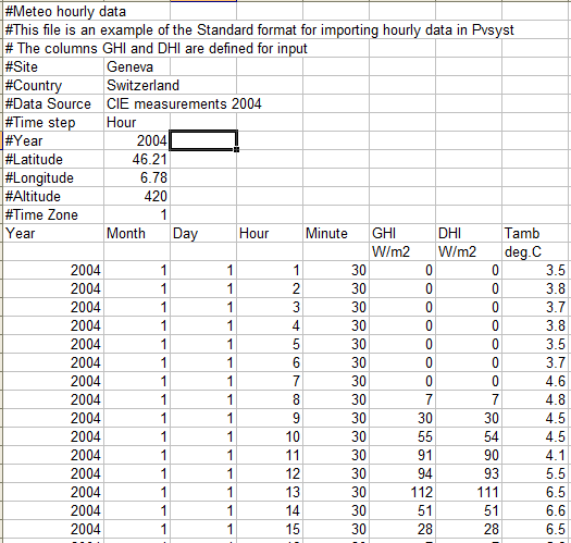

Leap years:
- Real data (with real year definition) should include 29 th February when necessary.
- Averaged data (with no specific year definition, i.e. 1990 or 2059) should never define 29th February.
In PVsyst, data which are not really measured (averaged months, synthetic generation) are marked with Year = 1990 or 2059.
Missing data:
The PVsyst simulation requires complete data (for relevant monthly or yearly sums).
Missing data should be labeled -99 (or less). During the import, the missing values will be replaced by an average of the corresponding hour of the previous and the next day.
Night data:
The night data are mandatory. For a full year of data, PVsyst expects 8760 (8784 for leap years) lines.
(*) Not used yet in PVSyst.
(**) Wind direction in degrees clockwise from North ( N = 0 or 360, E = 90, S = 180,W = 270 ).
Example:
