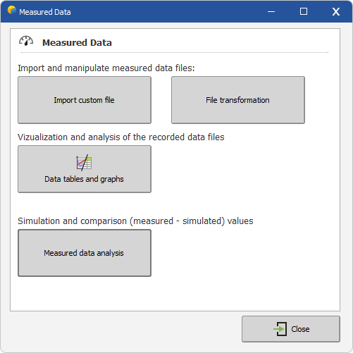

<< Click to Display Table of Contents >> Comparisons between measured and simulated values |
- Importing custom measured data files: allows to import measured hourly (or sub-hourly) data in almost any text CSV format.
- File transformation: technical tool for merging and cutting PVsyst measured data files.
| - | Data tables and graphs: powerful tool for visualizing and checking hourly measured data files. |
- Measured Data Analysis: parameter definition, simulation, and close comparisons between measured and simulated data.
