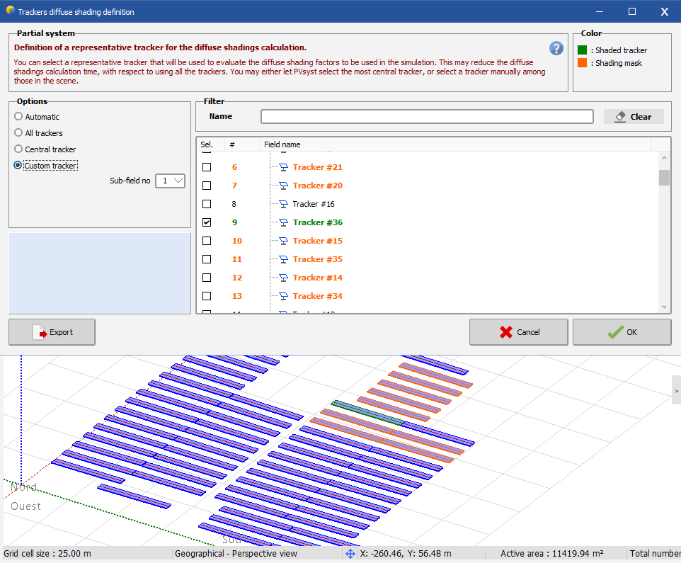

Tracker diffuse shading definition window (from version 7.3.0)
This window allows to select the most adapted calculation mode for the diffuse shadings of trackers. It is available as soon as trackers are defined in the scene, and is found from the shading scene construction window, via Tools > Trackers diffuse shadings definition.
There are several calculation modes, and by default the "Automatic" option is selected:
•All trackers
In this case, all trackers in the scene are considered for the diffuse shading calculation. This is the most precise calculation, but may become resource intensive for large or complex scenes.
•Central tracker
In this case, the tracker closest to the geometrical center of the scene is selected as representative sample for the whole scene. This tracker is highlighted in green both in the window and in the scene (legend: "Shaded tracker"), while the definition window is open. The neighboring trackers, used to cast shadings on the representative tracker are highlighted in orange (legend: "Shading mask"). Note that some arrangements of trackers invalidate the accuracy of the "central tracker" approach: if the central tracker is on the edge of a patch of trackers, the diffuse shadings will be underestimated.
•Custom tracker
Same as above, but with the possibility of manually selecting a tracker to be used as representative sample. The shading mask is defined automatically.
•Automatic
In this case PVsyst will select the best option between "All trackers" and "Central tracker", depending on the number of trackers in the scene. The threshold between both regimes can be changed in the advanced parameters ("Threshold number of tracker fields for partial scene") with a default value of 40. This is equivalent to the treatment used up to version 7.2.21 (see below).
The mode used for the diffuse shadings calculation is displayed in the report, under General parameters > Near Shadings.
