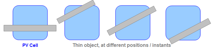

When a thin object throws a shade on a PV module (cell), the current in the cell will be limited to the illuminated area.
Let's call "Thin object ratio" the ratio of the thin object shade area, to the total area of the cell. The shading current reduction will be proportional to this Thin object ratio.
Now the thin object's position may depend on the cable orientation, or will move according to the sun's motion. We will assume that - on an average over any evolving conditions - it will be the wire width divided by the cell's size.
As an example, a wire of 300 mm2 has a diameter of the order of 20 mm. On a standard 6" cell, the thin object ratio will be 20 mm / 156 mm = 0.13.
Therefore, the current loss will be 13% in this cell. For the full string, the current will be the current in the worst cell, i.e. a loss of 13% whatever the number of cells shaded.

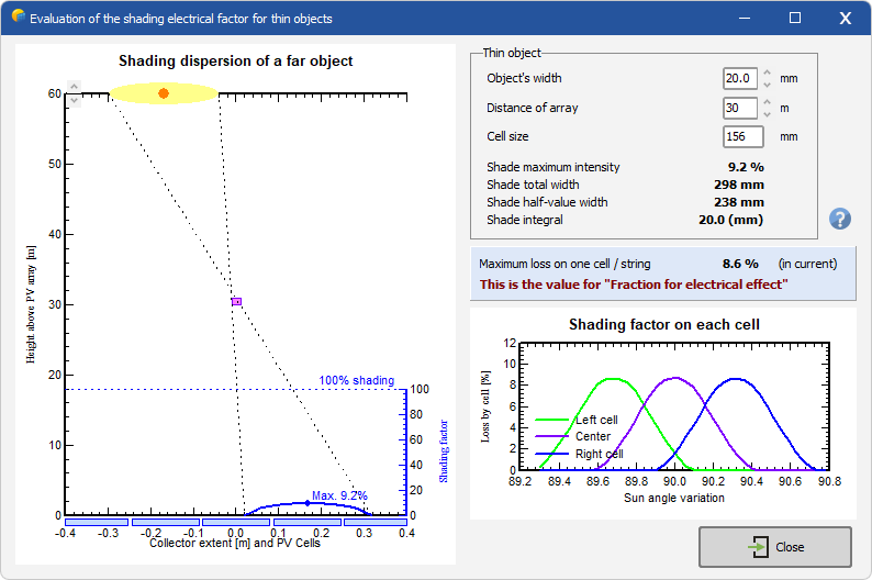

The Thin object tool is aiming to understand and evaluate this effect.
You will find this tool in the 3D editor menu, "Tools > Thin Objects Analyze tool".
You have to specify the object's width, the cell size and the distance of the object to the array.
This tool will show the shade trail on the PV module.
If the cable is very close, we will have a sharp trail of 20 mm in width, with a full shading on this cell (20 mm / 156 mm = 13%).
The example here shows a cable at 30 m over the PV array: the shade trail is about 30 cm wide, i.e. split onto several cells. Therefore the loss on one single cell will be lower.
Sun motion and shades distribution
You can move the sun's position with the red point: the shade will move on the cells. The global shading effect on each cell is shown on the plot as function of the sun's position: the maximum shading factor on one given cell at a given time is 8.6%: this will be the value we have to attribute to the "Fraction for electrical effect" for this thin object.
NB: even if you have several wires over this PV modules string, the current of the string will be limited by this value. The shading effects are not additive !
