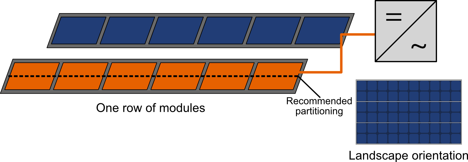

String inverters / All strings on a single MPPT are shaded in the same way
In the specific case of single-string inverters, or whenever all the strings (laid-out on one row) on a given MPPT input are shaded in the exact same way, modules in landscape orientation will suffer less from shadings than in the case of a central inverter. This is the case both for half-cut or standard cell modules (with three sub-modules in general). When shading the bottom row of cells, the loss of production will only be of about one third on clear-sky conditions, due to modules having three sub-modules in the height of the partition. Once all effects are taken into account, it was found that these strings are best modeled with two partitions per row of modules.

Summary for common cases
To summarize the cases above, we identify the configuration of the strings in the following way: Number of rows - Orientation - (optional) U-cabling.
"Number of rows" (marked as an integer number) is the number of rows in the height of the table spanned by all the strings of a given MPPT input. By default we suppose that the strings are laid out on one row. U-cabling (marked as U) is for the case where the strings are laid out over multiple rows in the height of the table. Finally the Orientation may either be L (standard or half-cut modules in landscape), P (standard modules in portrait), or T (half-cut modules in portrait).

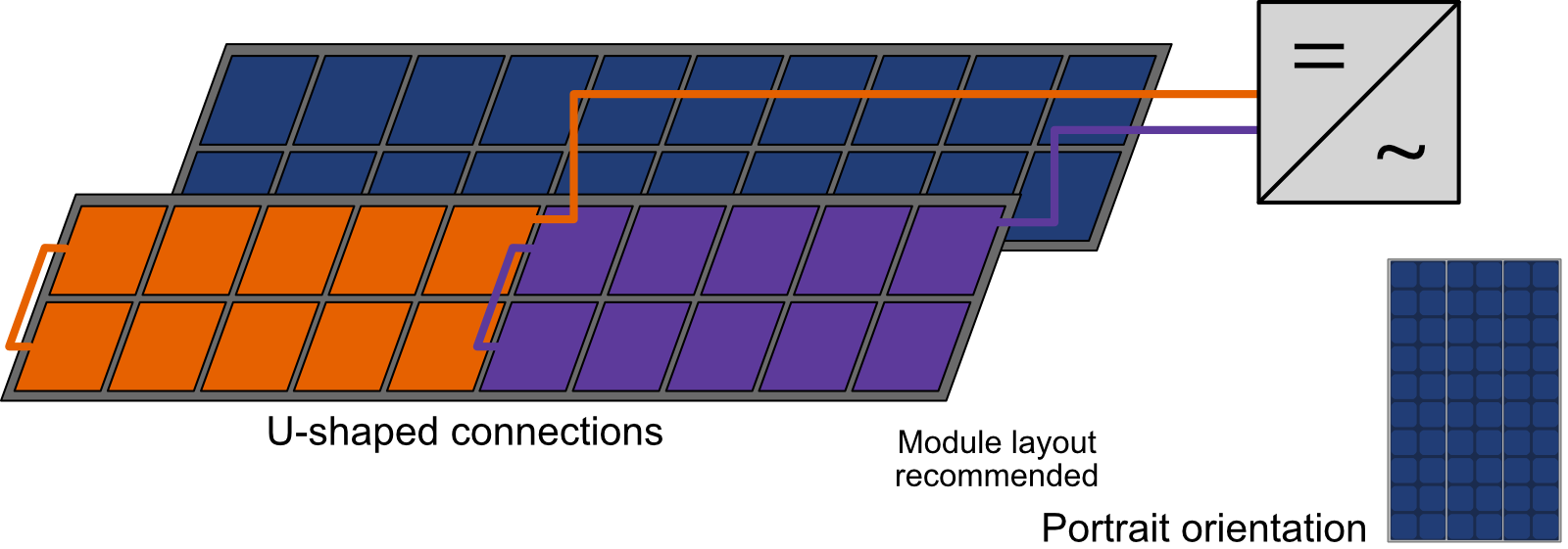

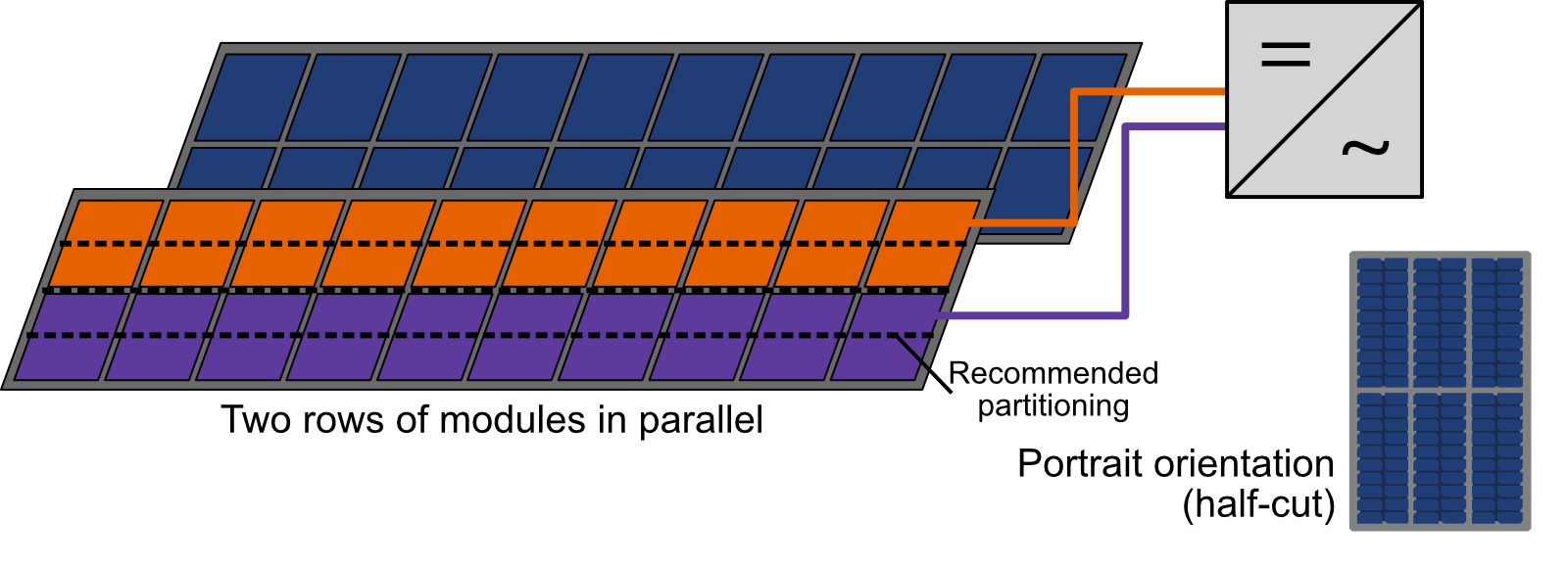

1L
2 partitions
string_layout_1L

string_layout_2L
xLU

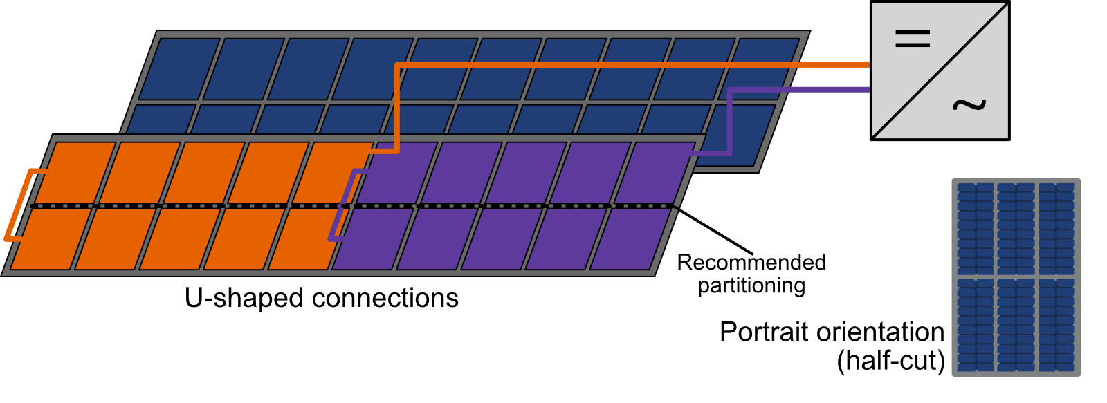

3x partitions
string_layout_2LU

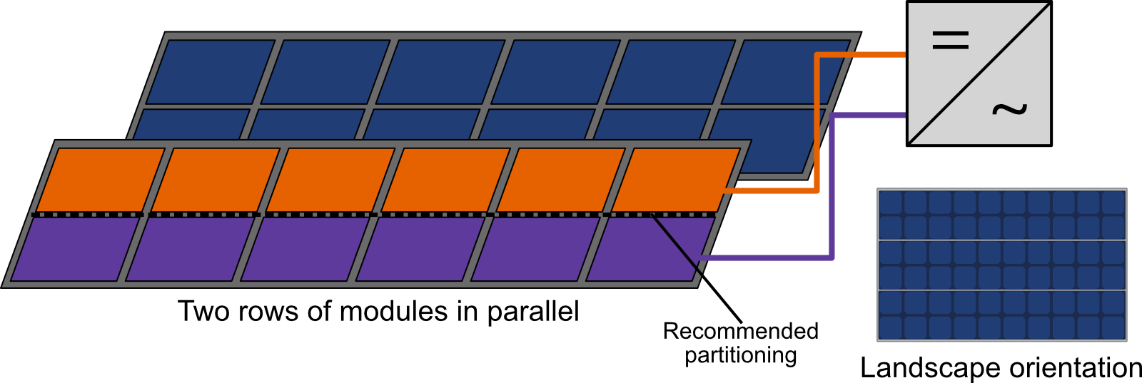

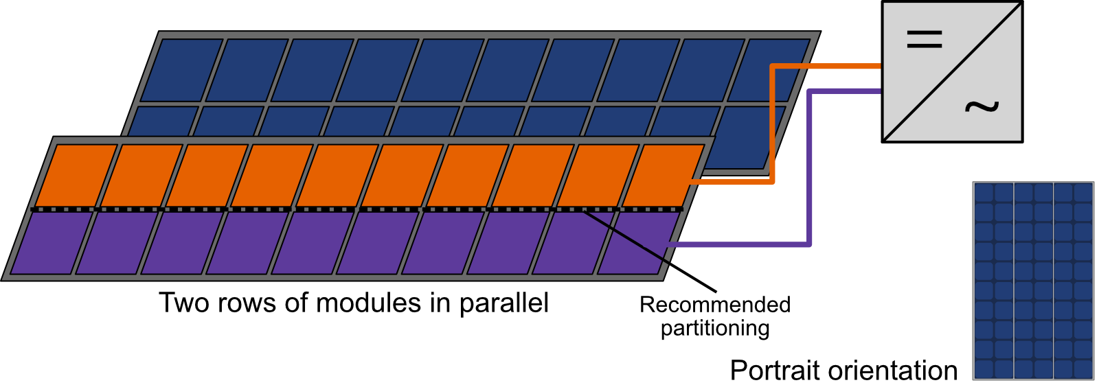

xP
x partitions
string_layout_2P

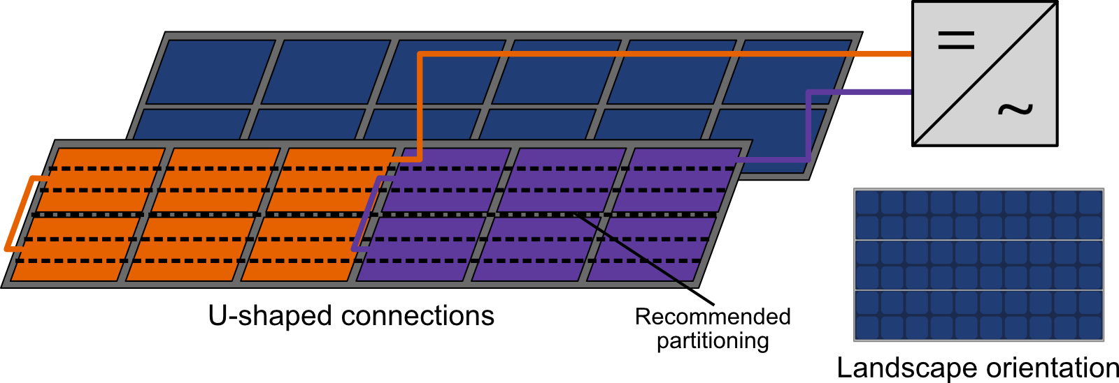

xTU
x partitions
string_layout_2TU
