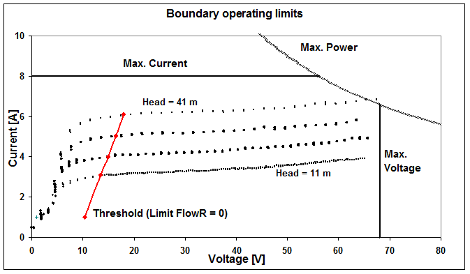

Boundary limits of the operating domain
and I/V measurements for pump Watermax BU (CIEMAT measurements)
The equation Φ=0 implies that only 3 of the 4 variables are independent. Therefore the model will provide relations allowing to calculate any one of the above variables, as functions of two others. The basic relations are:
| - | Ip = f (Up, HT), the fundamental relationship which will be used for determining the operating point when directly coupled to a PV array. |
| - | FR = f (Pp, HT), completing the preceding relation for determining the corresponding flowrate. |
| - | Pp = f (FR, HT) will be used for example for sizing the PV array power, or for determining the efficiency. |
The other relations may be obtained by numerically inverting these 3 fundamental ones.
As a complement, the model also provides functions for determining the Power, Voltage or Current threshold (i.e. the boundary where the flowrate drops to zero) as function of the Head.
