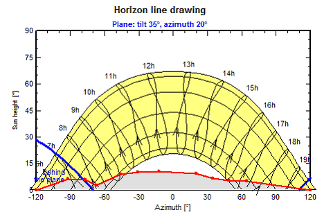

The Far Shadings operate in an ON/OFF mode: i.e., at a given time, the sun is or is not present on the field. When the sun is behind the horizon the beam component becomes null. But the diffuse component, supposed isotropic - coming from all points of the sky vault seen by the collectors with an identical intensity - is not much affected.
Clicking the "Horizon" button will open a graph of the sun paths at your location.
Defining horizon line by hand:
The horizon (Height, Azimuth) values may be recorded on-site using a compass and a clinometre (measuring the height angles) or a land surveyor instrument.
You can move any red point by dragging it with the mouse, or define accurately its values in Edit boxes.
To create a new point, right-click anywhere. To delete a point, right-click on this point.
You can of course save this horizon as a file for further use in other projects in PVsyst.
