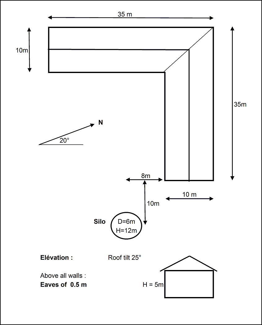

This is built from the following "architect" plan:

Here, choose "Parallelepiped" and define the sizes (Width = 10m, Length = 35m, Height = 5m).
- Click "OK", this will place the parallelepiped in the building object's referential.
- In the menu, choose again "Add object".
Here, choose "Parallelepiped" and define the sizes of the second wing of the farm (Width = 10m, Length = 25m, Height = 5m).
- Click "OK", this will place the parallelepiped in the building object's referential, positioned at the origin.

- Define the sizes: "Base width" = 11m, "Top length" = 30.5 m (for eaves), "Roof tilt" = 25°, and "Gable 1 angle" = -45°.
- Click "OK". This will put the roof in the building's scene. You can position it with the mouse and values as before (X = 5, Y = 5, and Z = 5, building heigth).

- In the main scene: "Object" / "New..." / "Elementary shading object" / "Portion of cylinder". According to the plan: define Radius = 3m, Aperture angle = 360°, Nb of segments = 16, Height = 12m. Click "OK".
