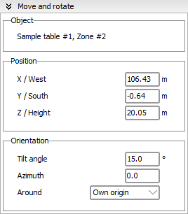

To position an object, use the MoveObject button or the "Object -> Position in scene" menu item.
The corresponding keyboard shortcut is [Ctrl + B].
This will show the positioning dialog:
ObjectPositioning
And it will also display the help tool for moving the object with the mouse directly in the scene:
MoveHelpTool

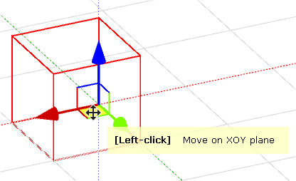

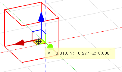

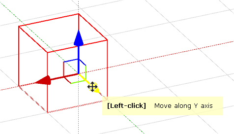

The help tool allows you to move the object on one or two axes as shown in the images below:
Moving an object on one axis
Moving an object on two axes
Left click and drag to move the object

From a mathematical point of view, parameters are defined in such a way that the object is first displaced in the main referential, then it is rotated by the given azimuth angle, and finally tilted around the new OX' rotated axis.
This process is the same for positioning an elementary object in a "building" object.
