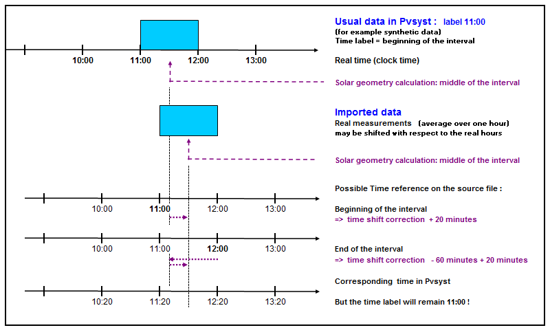

Each record usually holds a time label, which possibly doesn't correspond to the PVsyst definition.
Moreover, this time label may represent data measured (averaged) over a time period which doesn't correspond to the true Legal Time "round" hours.
Depending on authors or data acquisition systems, this time label definition may be:
| - | The beginning of the interval, as in PVsyst. |
| - | The end of the interval. |
| - | The middle of the interval (for example time label = 12:30). |
| - | Expressed in UT (Universal Time) rather than the local legal time. |
| - | Submitted to changes during the year (DST - Daily Saving Time). |
| - | Moreover this "reference" time may be shifted by some minutes with respect to the true Legal Time (11:20 to 12:20 in the following example). |
- The time periods may also be defined in sub-hourly values, which will be averaged in hourly values at the importing time.
Time Shift correction
Now for treating these meteo data, PVsyst has to determine the time at which the Solar Geometry will be computed.
In order to avoid model's errors, this time should be the exact middle of the averaging period for one hourly measurement.
In PVsyst, this is achieved by a particular parameter of the Meteo file, the Time Shift, which is the time difference (in minutes) between the effective calculation of the solar geometry, and the PVsyst usual definition (i.e. the half-hour).
This Time Shift will be used in any calculation involving the hourly meteo (e.g. the simulation).

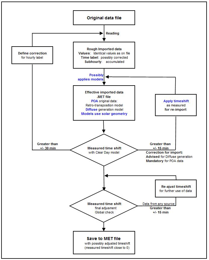

Time shift correction when importing data
PVsyst offers several tools for the evaluation of the time shift (either by comparison to the clear sky model, or using the Hourly Kt morning/evening graph).
Therefore when importing an unknown data set (especially with GlobInc/POA or unpecified diffuse):
- First import the data without precautions. The program will guide you to the graphs for the assertion of the correct time shift.
- Evaluate the effective time shift of your data.
- Apply the observed time shift corrections in the format protocol, and re-import the data.
If the effective time shift is less than +/-30 minutes (*):
- With the general ASCII importing tool, you should specify the "Time shift" parameter in the importing protocol.
- With PVsyst standard files, you can add a line #Time shift and the value in minutes in the header
- With other sources, you don't have the opportunity of changing the time shift at the import time, but you can adjust it for the future uses of the MET file. Usually the "known" files imported by "Import Meteo Data" are already corrected in the importing protocol.
If the effective time shift is more than +/-30 minutes (*): you have several means for the correction:
- With the general ASCII importing tool, you should specify the "Hour shift" parameter in the importing protocol.
- With PVsyst standard files, you can add a line #Hour shift and the value in hours in the header
- With other sources imported by "Import Meteo Data", if this arises, it is usually not a file compliant with the usual definitions of the concerned source.
- With all files, you can also modify the Time Label directly in the source file, by displacing the Time label column (in EXCEL, insert or delete one cell at the beginning of the column).
If there is a time shift varying along the year:
- With the general ASCII importing tool, consider using the DST correction (option "Summer Time > Apply").
- Otherwise there is no practical way, except modifying the dates directly in the source file.
If the file is written in UT (Universal Time):
- With the general ASCII importing tool, check the box "Universal time".
- With PVsyst standard format, you can add a line #Time Reference with the value UT
NB: In PVsyst, the time defined around sunrise and sunset for solar geometry is the middle of the interval when the sun is over the horizon.
NB: When importing data (especially from POA), PVsyst will limit the GlobHor to a reasonable value according to the clear sky model. This is the main cause of the discrepancy often observed between the POA original values and the transposed values.
(*): The true limit is specified by the Hidden parameter 'Maximum allowed time shift in Meteo data', under the category Miscellaneous : Meteo, Simulation
The following diagram summarizes the necessary steps for importing data from a custom or unknown data file.
