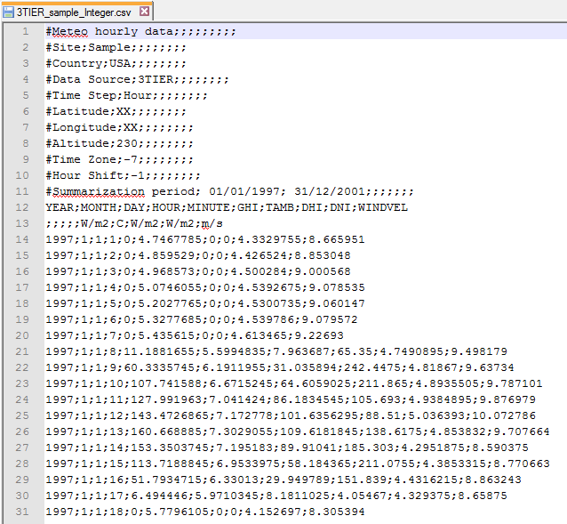

•Locations with Integer Time Zone :
   - The first line is labelled 1h0 minutes, which means that data was accumulated "from 0h to 1h".
   - PVSyst reads the label 1h0 minutes as "from 1h to 2h",
   - and will consequently consider that the data is +1h ahead compared to the sun position.
       => Tag Hour shift;-1;  required (means that a -1h correction will be applied when reading the data).
3TIER_header_PVSystStdFormat_IntergerUTCOffset

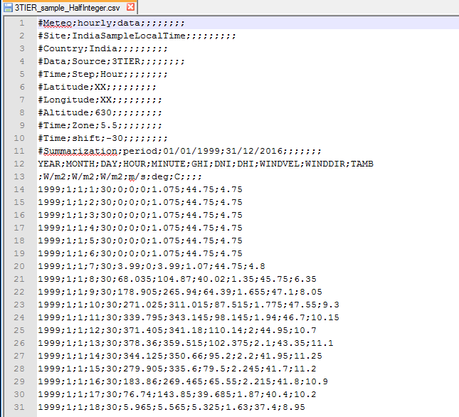

•Locations with half-integer Time Zone :
   - The first line is labelled 1h30 minutes, which means that data was accumulated "from 0h30 to1h30".
   - PVSyst reads the label 1h30 minutes as "from 1h to 2h"  (no reading of minutes),
   - and will consequently consider that the data is +30mn ahead compared to the sun position.
       => Tag Time Shift;-30; required (means that a -30mn correction will be applied when reading the data).
3TIER_header_PVSystStdFormat_HalfIntergerUTCOffset
