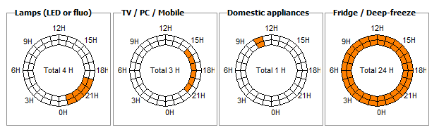

For each appliance, you should define:
- the number of devices, their individual power, the duration of their use.
- the operating hours in the day :
and the table will give the concerned energies.
You can define a daily profile for:
- The full year
- Seasonal values
- Monthly values
- With a weekly modulation (W-E use)
There is a tool for copying data from one month or season to other ones.
The Week-end option allows for concentrating the daily consumption on a specified number of days of the week only. This option may be specified independently for each season/month.
The Stand-by consumption may be extended to the week non-utilization days if desired.
