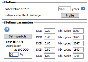

Definition in the Battery dialog

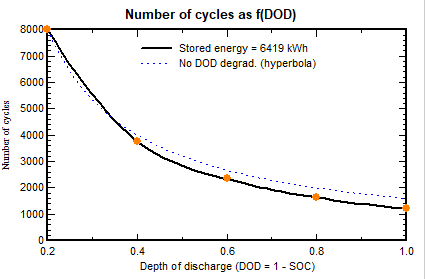

The dialog allows to explicitly define 5 points on the "Number of cycles" diagram. These points are stored in the BTR data file.
When clicking the "Lifetime => Profile" button, the edition of the points will appear along with the plot:
However there are some constraints: when the hyperbola is constructed on a given point, all other points should be close, but below the hyperbola.
Therefore there is a tool for constructing the hyperbola. When clicking the button "Set hyperbola", it will be constructed in order to pass by your specified point. So that you can define the number of cycles proposed by the datasheet (usually one only point).
Degradation
You may also define an additional degradation, taking into account the accelerated aging (diminution of number of cycles) due to the depth of discharge.
PVsyst proposes a degradation rate which is proportional to the DOD, the parameter being the percentage of cycles lost if all discharges were at 100%.
