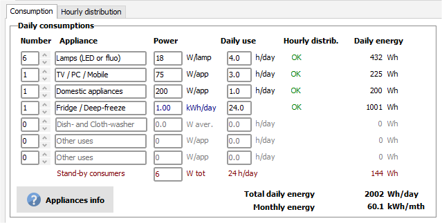

For each appliance, you should define:
- the number of devices, their individual power, the duration of their use.

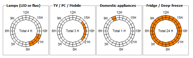

- the operating hours in the day :
and the table will give the concerned energies.

The Stand-by consumption may be extended to the week non-utilization days if desired.
