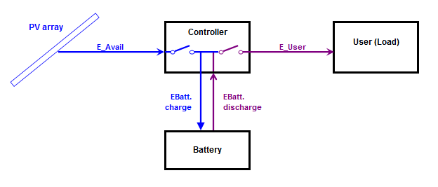

Very little stand-alone systems (SHS: Solar Home Systems)
This concerns little systems (50 to 200 Wp) with a very limited consumption (some lights, radio-TV, computer, no fridge).
With these simple systems, the PV array (one or few modules) may be connected directly to the battery, without power conditioning. This implies that the PV modules should be "12V" or "24V" modules, i.e. with 36 or 72 cells.
This kind of installations is managed with very simple controllers, acting either by disconnecting the battery, or short-circuiting the PV modules when the battery is full.
These controllers have always the ability of controlling the load when the battery is empty.

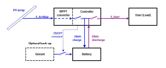

Medium power systems (Little household, communications)
These systems range usually between 400 Wp and 4 kWp.
The controller includes a power conditioning unit, able to perform the maximum Power Tracking on the PV array. Therefore the PV array voltage is no more related to the Battery pack voltage.
Most of the times, the controller is also able to ensure the load control, with a limited current capability (usually of the order of the charging current).
These installations may power lighting, fridges, wash machines, little electro-tools, etc. These may also be used in some little remote communication stations.
The energy may be used as DC energy, or fed as AC energy through a little inverter ("Battery inverter").
In the present time, PVsyst doesn't implement the inverter. The Load is specified as energy, whatever the way it will be used.
Such systems may - rarely - be supported by a back-up generator in case of lack of energy. If automatic, the Genset start/stop command should be managed by the controller.

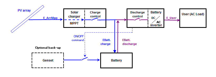

High power systems (Household, communication relays, isolated little industry, etc)
These may be stand-alone systems of 2 kWp to several dozens of kWp.
Such installations are using one (or several) "Solar chargers", equipped with MPPT converters, and DC/AC battery inverters.
The controller is no more a single device: the charging control is ensured by the Solar charger (sometimes several in parallel), and the discharge control by the inverter. The inverter should also manage the back-up generator if any.
In PVsyst, we consider the Solar Charger as the "Controller for Stand Alone" component. For historical reasons (and simplification) this PVsyst component has also to control the discharge and the back-up generator. But as the parameters for these functions are not defined within the "Solar charger" physical devices (data sheets), the internal parameters for these controls (maximum current, thresholds, etc) will remain in the dialog of this component, but their values will be defined within the system. Their initial values will be adapted from the system configuration, and will be modifiable according to the real Inverter used, or other other control device.
