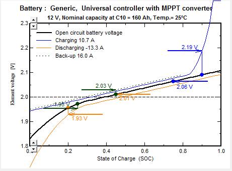

PV array Charging control: On the figure below, we can observe that the charging disconnect condition is rather easy, as the voltage slope is enhanced by the "gassing" phenomenon (dissociation of the electrolyte), which adds a significant voltage "loss".
However when the controller switches OFF, the battery voltage brutally drops to the "linear" behavior (or more exactly a curve corresponding to the discharging current if a load is connected). The reconnecting voltage should of course not exceed this voltage, otherwise the system will oscillate. The reconnecting voltage is very difficult to establish and optimize, because we move on the linear SOC region with low voltage variation, and the controller doesn't "know" the load current. When the system attains the reconnecting point, it will jump to the blue charging curve.

Load disconnect control: when approaching deep depth of discharge the PVsyst battery model also defines an enhanced voltage drop, which facilitates the decision of switching OFF. However this voltage is highly depending on the discharge current, especially for batteries with high internal resistances. Again, when disconnecting the load the voltage will suddenly increase, and we should be sure to specify a sufficient hysteresis for the reconnecting threshold, at least above the orange point, for avoiding oscillations.
The reconnection should ensure a significant SOC increase, but the reconnection voltage is extremely sensitive (18 mV for a SOC variation of 0.1), and the uncertainties due to the temperature and other phenomenons is important. .
Back-up generator management: when a genset is managed by the controller, the start of the genset should arise before cutting the load for deep discharge of course ! Therefore the BackUp ON threshold should be above the Discharge OFF voltage condition. Again, the reference point for starting the genset is situated on the orange curve.
But the stopping voltage condition will take place on the blue dotted line. As the current provided by the genset is usually rather high, the stopping threshold should take the voltage drop of the charging current into account. Avoiding oscillations and ensuring a reasonable recharge will require a big hysteresis !

The tool (diagram above) shows that the relations between these 3 values are the following:
  • The difference between VThreshEff and VThreshRef is only related to the Controller's temperature coefficient
  • The SOCThresh with respect to the VThreshEff is "a priori" only dependent on the Battery Current. However if the battery temperature coefficient is not the same as the controller's one, there will also be a temperature dependency.
  • The SOCThresh with respect to the VThreshRef is depending on both the temperature and the currents.
You are advised to play with these parameters for a better understanding of the relationships and their consequences.
