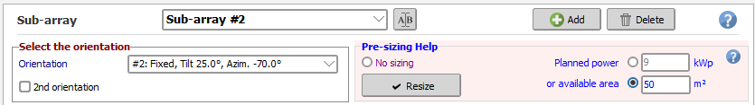

One sub-array of 50m² linked to orientation #1:
One sub-array of 50m² linked to orientation #2:

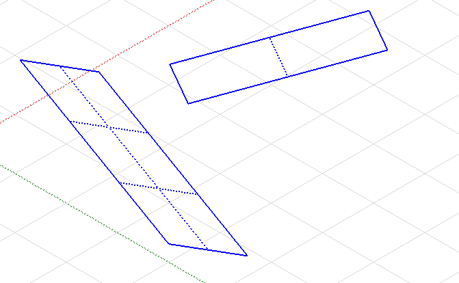

Two rectangular fields, one of 50m² assigned to orientation #1 and another of 160m² assigned to orientation #2:

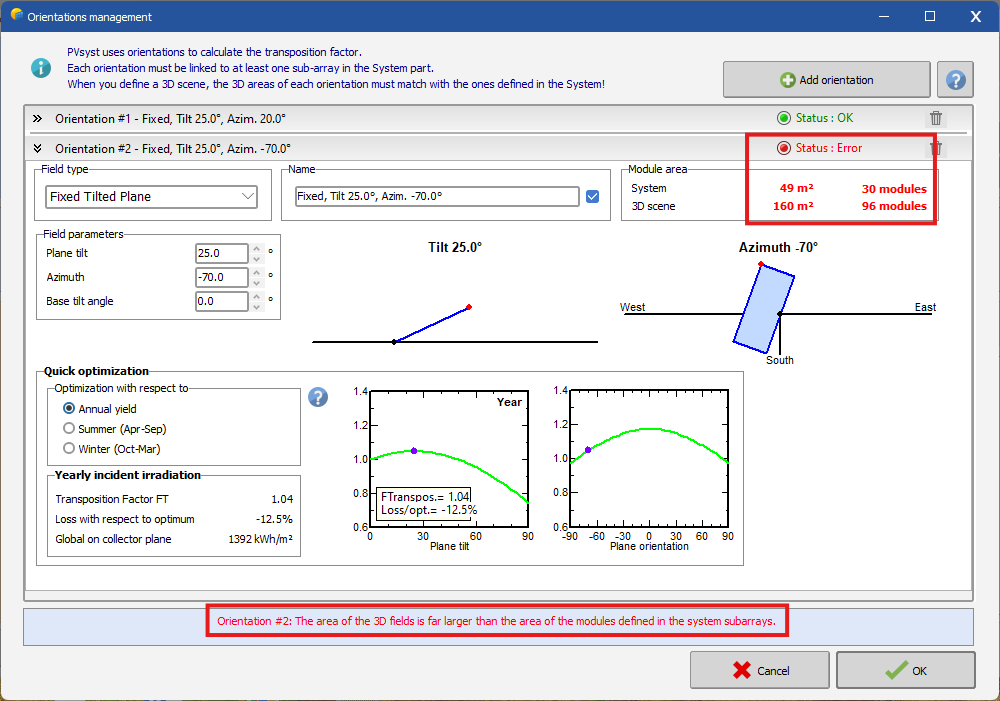

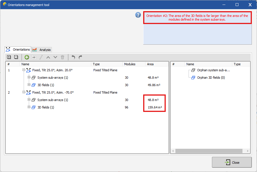

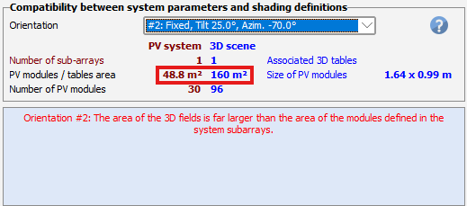

You can see that there is a mismatch between the system and the shadings scene at three different spots.
First in the "Orientation management tool":
Second when you close the shadings scene:
Last in the "Orientation" window:
Interpretation and solution
We can see that the second orientation is marked with a red icon, when the first one is green. This means that it is not matching the system correctly and needs some adjustments.

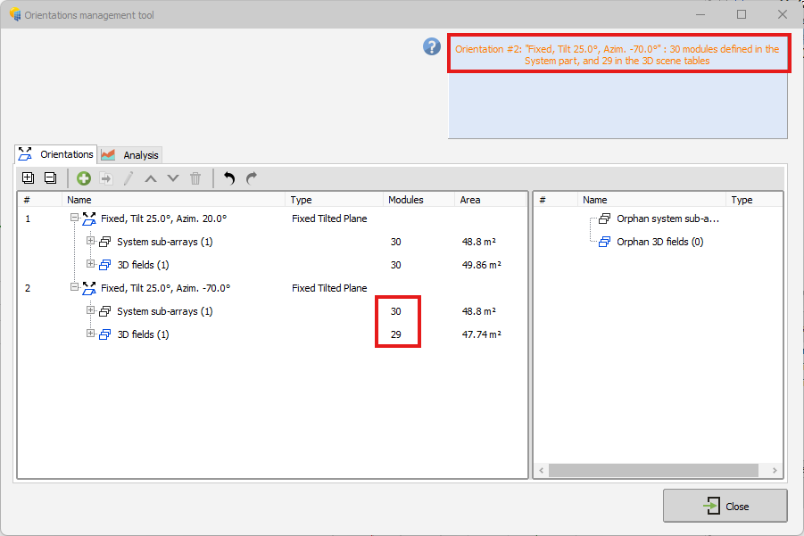

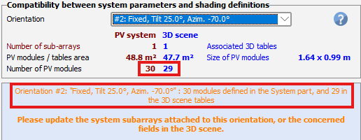

After decreasing the field size, it's area is now 47.74m² and the previous windows now display an orange warning instead of an error:

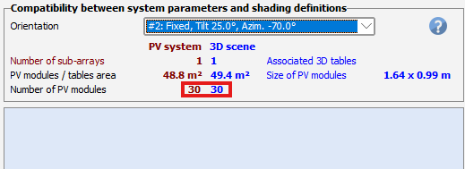

This warning is because the number of modules do not match between the scene and the system. The warning will not prevent the simulation from running but it is advised to fix it if you can. In our case we will fix it and now we see that the warning has disappeared:
The orientation #2 area is really close to the System one and the number of modules are the same so it is considered as fully matching.
