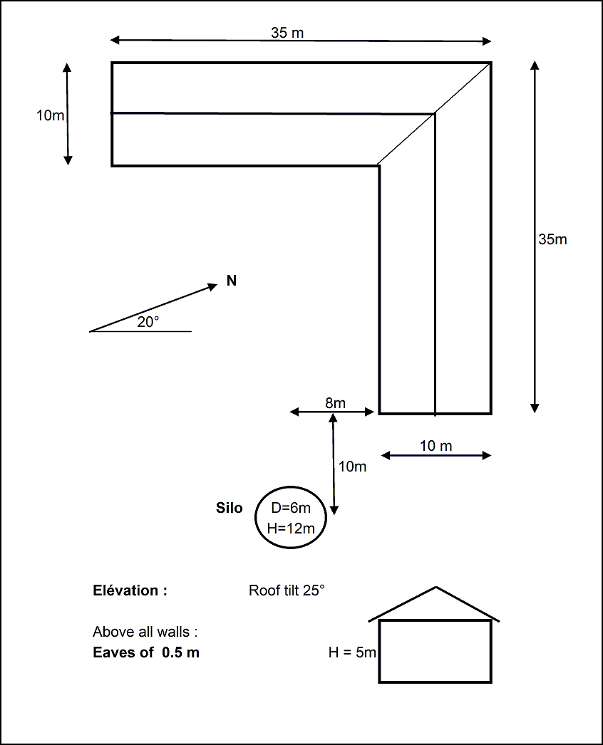

This is built from the following "architect" plan:
Tutorial_Farm_Sketch2

  • In the menu, choose Create / Building/Composed object. This will open a secondary 3D window, which is the referential of the building object.
  • In the menu, choose Add object.
    • Here, choose "Parallelepiped" and define the sizes (Width = 10m, Length = 35m, Height = 5m).
    • Click OK, this will place the parallelepiped in the building object's referential.
  • In the menu, choose again Add object.
    • Here, choose "Parallelepiped" and define the sizes of the second wing of the farm (Width = 10m, Length = 25m, Height = 5m).
    • Click OK, this will place the parallelepiped in the building object's referential, positioned at the origin.

  • Main menu Elementary Object / New object and choose Two-sided roof + Gables.
  • Define the sizes: "Base width" = 11m, "Top length" = 30.5 m (for eaves), "Roof tilt" = 25°, and "Gable 1 angle" = -45°.
  • Click OK. This will put the roof in the building's scene. You can position it with the mouse and values as before (X = 5, Y = 5, and Z = 5, building heigth).

  • In the main scene: Object / New... / Elementary shading object / Portion of cylinder. According to the plan: define Radius = 3m, Aperture angle = 360°, Nb of segments = 16, Height = 12m. Click OK.
  • In the main scene, be sure that the "Positioning" tool is activated, click "Top view" and position the silo with the mouse (if you do not know the order of magnitude or signs), and then with values (X = 18m, Y = 45 m).
