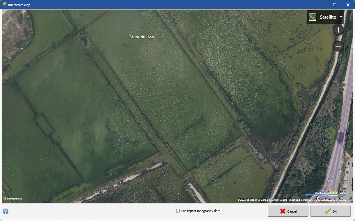

In the near shadings you can click on File > Import > Download a satellite ground image and/or ground data in the menu to open the following window:
TopographyImport
On this window you will see the satellite view of your project location.
You can click and drag with your mouse to move around. However you will not be able to go very far from the original location to keep the consistency between your project location and the terrain data that you will be importing.
On the top right of the screen you will be able to switch between the "Satellite" and the "Map" view. You will also be able to zoom in and zoom out using the "+" and "-" buttons.
Clicking the "Also import topography data" checkbox will allow you to also import the terrain data and not only the ground image.
When clicking on the "OK" button, PVsyst will download the ground image exactly as you see it in the window — the captured area follows the window size, so enlarging the window before clicking OK imports a larger area. If the topography option is checked, the terrain data covers the same area as the ground image. Both are imported at the correct scale and aligned with each other.
