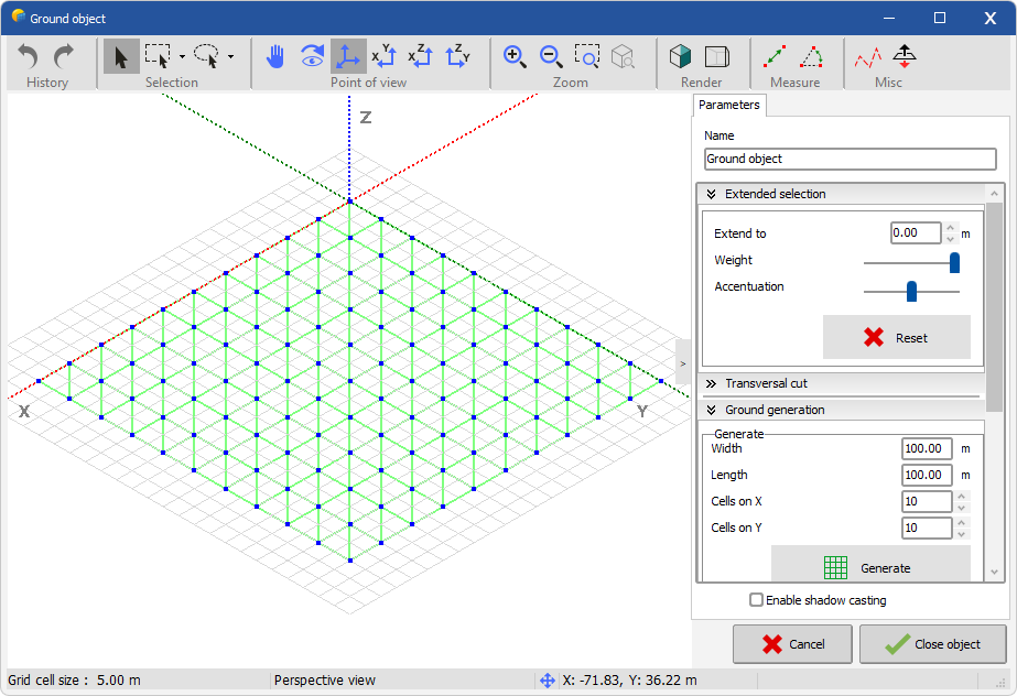

The following window appears when editing a Ground object.
A Ground object is a mesh of points, which means that all the building process will only manipulate points.
Scene tools
Choose this tool to select individual points. Use Shift key to add or remove points from your current selection.
Choose this tool to select points by drawing a rectangle on the scene. Use Shift key to add or remove points from your current selection.
This tool allows you to draw a transversal cut on the scene in order to view it on the right panel.
This tool allows you to invert the faces normals.
Panels
Ground generation
The "Ground generation" panel defines the ground dimensions and the complexity of the mesh. Clicking on the Generate button will remove the current ground and replace it with the new one.
Selection position
This panel allows you to move the points you selected to a given position. Each point will remain at the same distance to the other points, this panel will just slide the whole selection as a whole.
Extended selection
This panel allows you to extend your selection. You can specify 3 parameters :
- Extend to: this will select the points around your current selection up to the given distance
- Weight: this will decrease the selection weight on new points depending on their distance with the current selection
- Accentuation: this will alter the weight in a parabolic way so that closer points will weigh more while further points will weigh less
Transversal cut
You can use the slide bar to move the transversal cut along its normal axis.
The button sets the point of view to see the transversal cut from the side.
