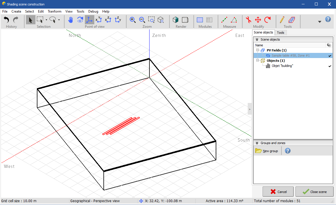

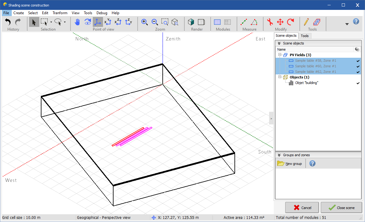

First select the single tables you want to convert in the 3D scene:

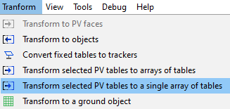

Then click on the menu called "Transform -> Transform selected PV tables to a single array of tables":

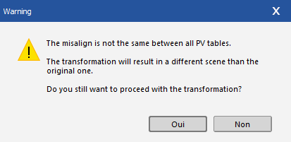

In case PVsyst detects differences between the tables (different alignment, different orientations, etc) you will be presented with a warning popup summarizing the differences and asking if you want to proceed or not. Remember that if you proceed your scene will become different:
