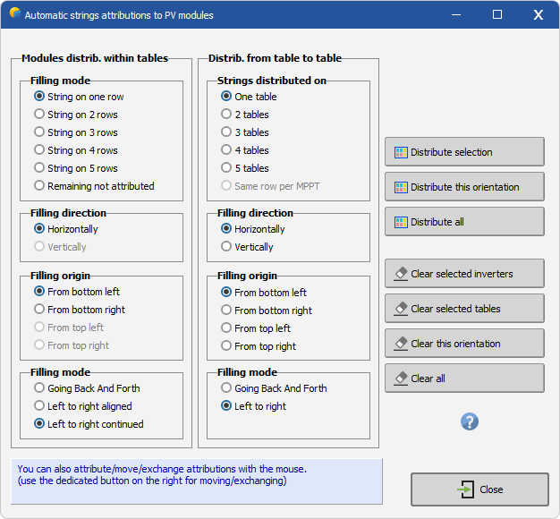

The allocation of each PV module to a string may be done manually using the mouse. However with big systems, this is obviously not viable.
PVsyst offers a wide set of rules for distributing the strings according to different strategies.
This tool is available with the button Auto attribution, which opens the following dialog:

Some final adjustments may be done manually, by exchanging attributions with the mouse (use the icon on the right).

Distribution of strings on "big" tables
When we have big tables, receiving several full strings, the concerned dialog is mainly the "Module distribution within a table".
Here we may define:
- All modules of a string on a same row. This is the usual configuration in sheds, when you want to minimize the effect of the shadings: you have to group all the modules of a string in a same row, in order that each module is shaded in the same way.
- Strings on two rows. This is also a common choice in some applications, often called "U-connection". Although this may simplify the wiring, this is not optimal for the mutual shadings.
- Strings on 3, 4 or 5 rows: not a usual choice.
- If the filling is not complete, the option "Remaining not attributed" will complete all the "free" modules without positioning constraints.
- Filling direction: we may specify whether the filling is made horizontally (usual in sheds) or vertically (special cases).
- Filling origin: all options possible.
- Filling mode: useful when the number of modules doesn't match the table width.
- Left to right: Each string is beginning at the left. If there are remaining modules on the right, they will be filled by an additional string. This lead to a "regular" layout.
- Going Back and Forth: the bottom row is filled with strings one after the other. If remaining modules at the end of the table, this will begin a new row beginning from the right. This way you will never have modules connections of a given string extending over the whole table. However the distribution leads to strings on two (or more) different rows within the table, which is not optimal.
NB: Some strategy configurations may let unassigned modules. You have always the opportunity of using "Remaining not attributed" for completing the holes.
Distribution of strings on "little" tables
More and more ground-mounted systems are made of little independent tables (some few modules in width) usually for following the terrain slope.
When we want to minimize the mutual shading effects, we have to put all the modules belonging to a same string in the same shading situation (for ex. at the bottom of each table).
The right part of the dialog "Strings distributed on XX tables" indicates how to choose the tables sequence when distributing one string. Depending on the number of modules in a string, you can choose:
- Strings distributed on one table: the next table is filled only when the preceding one is fully attributed. There may be one string distributed on two contiguous tables if the number or modules exceeds the room on the table. |
- Strings distributed on two, three, four, five tables: this should be adjusted according to your system (number of modules in the table width, with respect to number of modules in the string). In the example of the previous page, we have defined 4 tables of four modules, receiving the 16 modules of one string. This is an ideal case of course, where the number of modules in each string fits the number of positions on each table. This is not always the case. However when distributing strings on different tables, think about the wiring execution !
- Again, you may choose whether you want to fill the tables on a line (one table next to the other), or on a column (one table behind the other).
- You can choose from which corner (of the tables matrix) you begin the scan.
- You can choose whether you want to fill the tables "from left to right", or "Going back and forth".
NB: the option "Same row per MPPT" corresponds to a very special configuration, when you want to put all strings of a complete MPPT input on a same row in all tables. This is an optimal configuration for limiting the electrical losses. However this is practically applicable only when you have string inverters (2-3 strings on one MPPT input).
