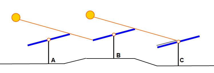

In the case of irregular tracker heights—on a hill, for example—no single tracking angle allows a perfect backtracking strategy. There will always be either some shading or irradiance "lost" on the ground. This is illustrated in the figures below.
Backtracking_DiffAltitude
When the backtracking angle is calculated for trackers A and B (at higher altitude), a shadow on tracker C (at lower altitude) is unavoidable. Here, half the tracker is shaded.

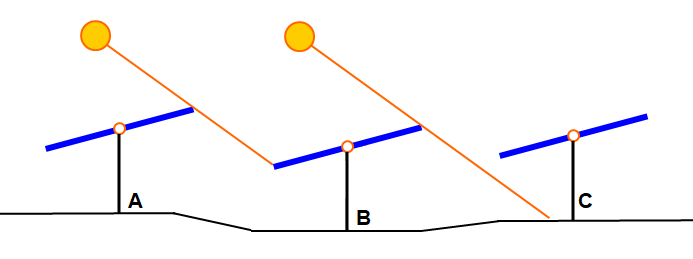

Backtracking_DiffAltitudeB
Conversely, when tracker B is lower than tracker A, tracker C does not have an optimal tilt for collecting the full available sunlight. A better tilt would intercept more light—this corresponds to a loss due to the cosine effect.
