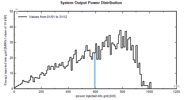

Energy distribution Histograms
Consider the example of energy accumulated as a function of power.
The considered PV plant is a simple system in sheds, of PNomPV = 1.126 MWp and inverters PNomac = 1 MW.
A bin or class is the accumulation of the energy for each simulation time step when the power lies between the 2 values Pn and Pn+1.
This example shows in blue the "bin" between 590 and 600 kW. Its height represents the total energy produced during the year, when the system was running between 590 and 600 kW.

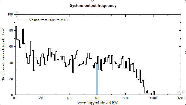

Operating time distribution Histograms
We can do the same exercise by accumulating the operating time (number of hours), again as a function of the power.
Here the blue bar height represents the number of hours in the year, during which the system power operated between 590 and 600 kW.
This gives a different figure, as in the previous graph the energy is increasing with the power.

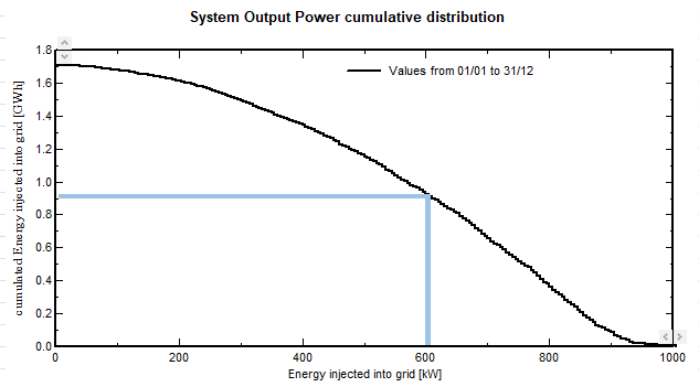

Cumulative distribution
In the cumulative distribution, each class contains the total energy of all running situations when the power was superior to the considered class power.
Therefore the first class contains the whole production of the year (here about 1.7 GWh).
It is observed that 0.92 GWh are produced when the system operates above 600 kW, representing 54% of the annual production.
