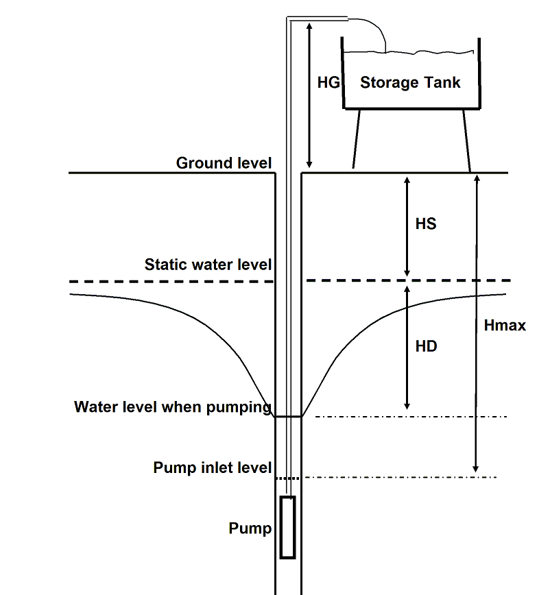

Remember that the Pressure or Head is mainly related to the difference between the input and output levels. The pump has to provide a total head resulting of several contributions.
In PVsyst we take reference to the ground level, we have (cf fig):
\(HT = HG + HS + HD + HF\)
where:
HG = head due to the height of the outlet pipe above the ground (assuming that outlet pressure is negligible).
HS = static head due to the depth of the water level in the well, in absence of any pumping.
HD = dynamic "drawdown" head: in a borehole well, the effective water level is dynamically lowered by the water flow extraction (see below).
HF = friction losses in the piping circuit, which depend on the flowrate.
For this system, in the "Pumping Hydraulic definitions" dialog, you will be asked to specify:
- The static depth. This may be also be given in seasonal or monthly values, in the "Water Needs" next dialog.
- The maximum pumping depth, corresponding to the inlet aspiration level. The system will stop the pump when the dynamic level reaches this level, avoiding dry running.
- The Pump depth, should be below the maximum pumping depth,
- The borehole diameter (in cm),
- The specific drawdown, expressed in [m/m3/h]: this is a characteristics of the borehole and the surrounding ground (see Deep well modelling).
You will also define the Storage Tank and Hydraulic circuit parameters.
A little graphical tool shows the total head and its contributions, as a function of pump flowrate.
