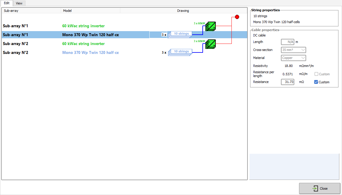

Single line diagram editor
The editor of the single line diagram allows to see the tree structure of the system circuit on the left side. The properties of the selected node are displayed on the right side.The different nodes are the components like strings, inverters, combiner boxes, transformers, and so on. They are connected by cables which are drawn in blue for the DC part of the circuit and in red for the AC part. Each node is a line in the tree view with two column entries on the left. The first column indicates the sub-array from 'System' to which this node belongs. The second column contains information on PV module and inverter types.
Each node has a single set of outgoing cables that link it to its parent node. The cable properties displayed on the right side are always the properties of the outgoing cables of the selected node.
^ Single line diagram editing tab.
Currently the editor allows only a very reduced number of operations on the circuit, mainly consisting in grouping or un-grouping the nodes. In future PVsyst versions this options will increase and eventually it will become possible to edit the components from within this circuit view. So far there is no undo-function in the editor, we therefore recommend to be careful with the ungrouping functions, as they may lead to large trees that are difficult to work with.
The nodes can represent a single object or groups of several objects. The grouping is only possible if the nodes are identical, including all its children. The properties of the different types of nodes are explained below. If the node consists of a group of components, the children nodes are shown only once. To make clear that each of these children exists in each component of the group, the multiplicity is shown left to the child node. In the example above, there are two groups of three inverters each. Each inverter has a group of ten strings connected to it. The transformer nodes are an exception to this, if they represent a group, all children will be represented in the diagram (see also the explanation of transformer nodes in the following).

Cables
Each node, except for the injection point node, has an outgoing cable to the right. In the DC part of the circuit the cables are drawn in blue, while for the AC part they are drawn in red. If the cable properties are defined in the 'Detailed losses' dialog, then the cable is drawn in bold, else it will be a simple line. The cable properties, if defined, are indicated on the right side. There are two ways for displaying the cable properties, either by their resistance, or by their length, cross-section and material. The display will follow the way the cables where defined in the tab 'Ohmic losses' from the window 'Detailed losses'. If the cables have a defined length, it will also be displayed next to the cable itself, as in the example of the combiner box above.

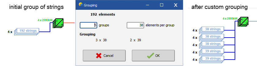

Un-grouping and grouping nodes
To un-group or group nodes, you need to select them first and then do a right-click with the mouse on them. This will open a context menu with the options 'group', 'ungroup' and 'custom group'. The different options will only be active if the selected nodes allow for this functionality. If for example only nodes with single strings are selected, the un-grouping will not be possible. Similarly, if non-identical nodes are selected, the grouping function will not be available.
When selecting 'ungroup', the program will split a node into nodes with single elements. For nodes with many elements this is not very practical. In these cases, the function 'custom group' allows you to reorganize a node or a selection of nodes into a given number of groups. When selecting this function, a small dialog pops up which allows to regroup the elements. You can either provide the number of groups that should be created, or the number of elements that should be in each group. If the total number of elements is not a multiple of these two figures, then two kinds of groups will be created, which will differ only by one in the number of elements.
Example:
In the following example a node with 192 elements, strings in this case, is split into five groups. As can be seen, this results in 3 groups of 38 strings and two groups of 39 strings, making for a total of 192 strings. Note that this grouping result is now set for all four inverters in this example. Ungrouping the inverters would yield 4 inverter nodes, each one with 5 groups of strings identical to the right side of the example.
If instead of choosing the number of groups, we would have entered 38 for the number of elements, the grouping would have been done differently. The algorithm builds as many groups of 38 elements as possible, and puts the remaining elements, if any, into one separate group.

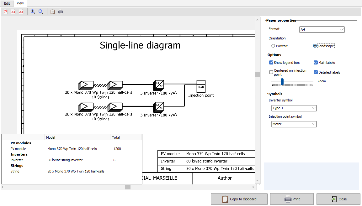

Single line diagram viewer
The viewer of the single line diagram shows a drawing of the system circuit. several parameters driving the rendering of the diagram can be customized, and the drawing can be sent to a printer. It is also possible to include this drawing of the single line diagram in the PVsyst report. Clicking and dragging on the drawing will move the paper, while the mouse wheel allows to zoom in or out.
^ Single line diagram view tab.
Paper properties
In this group of controls you can choose to have the diagram in portrait or landscape orientation. The supported paper sizes are A1 - A4 as well as US letter and legal.
A part of this functionality is also replicated in the toolbar on the top of the window. There is a button to toggle the orientation and two shortcuts for A4 and A3 paper format.
Options
The option group allows to toggle the visibility of the labels, and to include or exclude the legend at the bottom of the diagram. There is also a slider to zoom in and out. The zooming function is also accessible via the mouse wheel or the two buttons in the toolbar.
If the option 'Center on injection point' is checked, the injection point will be vertically centered on the diagram, and the child nodes will exit to the top and to the bottom. Each node in the diagram will position its children in a similar way.
Symbols
In the 'Symbols' group you can choose how the inverters and the injection point are drawn.
There are three options for the inverters:
and three options for the injection point:
Printing
The Print buttons open the print preview for the single line diagram. There is one print button at the bottom of the dialog, and one in the toolbar on the top.
In the print preview you can set the client logo via the 'Report options'. For the output you can either send this page directly to a printer, save it as a PDF file or copy the page as a picture to the windows clipboard, so that it can be pasted in another document.
