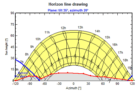

Clicking the Horizon button will open a graph of the sun paths at your location.
Tutorial_Project_Solar_Graph
Defining horizon line by hand
The horizon (Height, Azimuth) values may be recorded on-site using a compass and a clinometre (measuring the height angles) or a land surveyor instrument.
You can move any red point by dragging it with the mouse, or define accurately its values in Edit boxes.
To create a new point, right-click anywhere. To delete a point, right-click on this point.
You can of course save this horizon as a file for further use in other projects in PVsyst.
